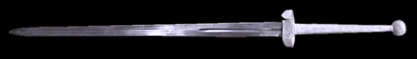

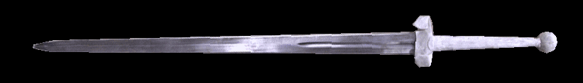

PostPosted: Thu 08 Apr, 2010 1:37 pm    Post subject:         Reply with quote
I took the liberty to quickly adjust the griplength on Sean's claysketch photo just to give an idea on what it might look like with longer grip. I think it works just fine. I just added about 4" to the grip but it's offcourse possible to add even more.

PostPosted: Thu 08 Apr, 2010 11:22 pm    Post subject:         Reply with quote
With the shorter blade and overall shorter length you may consider the type with broader guard and small scent stopper pommel (or sphere: your choice). These are pretty common in this size.
A completely different look, but you will make something there is plenty of support for. I think that perhaps your blade is even better suited for that kind of sword. If you lengthen the tang by welding, just make sure you heat cycle the weld a few times, to reduce grain size. Also pre-heat before the weld is done.
Should work out fine.
