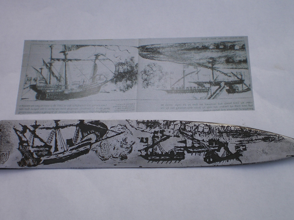

I recently used undiluted silver etch (nitric mostly) and it was a bit too aggressive. Here's a photo.
Matt
[img][/img]

PostPosted: Mon 18 Jan, 2010 8:04 am    Post subject:         Reply with quote
Matthew Fedele wrote:
They had a good variety of acids and the knowledge to create them including hydrochloric (muriatic) and acetic (vinegar.)
Matt
[img][/img]
How did you get that image transferred to the blade? If you free-handed that, you're amazing!

PostPosted: Mon 18 Jan, 2010 5:46 pm    Post subject:         Reply with quote
Matt
[img][/img]
Well thank you, but I'm a long way from reproducing woodcuts in steel. Conversely, it is much better than my original chicken scratches in brass. I've been playing with etching on and off for years now and it has been challenging.
This was done with relief. You have to thin the asphaltum with naptha until it's like paint. I use a sharpie a sketch the design, paint on the asphaltum with a brush around the designs, wait until it dries and scratch in the details with a metal scribe. The sharpie doesn't survive long enough as an acid mask with steel. Relief has been working better for me than the hard ground Leo was talking about. With the hard ground, you have to heat the asphaltum/beeswax/rosin mix to the right temperature and the piece has to be raised to the correct temperature too. Too cool and the mixture clumps and if too hot the mask begins to run and separate. Hard ground done properly though should give you excellent detail.
