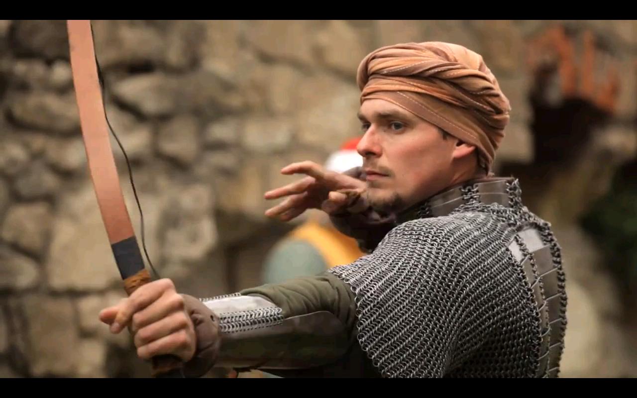

PostPosted: Tue 13 Nov, 2012 11:36 pm    Post subject:         Reply with quote
There is an other method of making the collar rigid: build in small plates. I made my armour's neck with two rows of plate, and now it works well. I sewed a strip of padded cloth to its inner side.
First I tried with lacing, but it didn't work for me. The collar wasn't rigid enough, it rolled over. When I strained it stronger, it strangled me. Eek!

PostPosted: Wed 14 Nov, 2012 11:58 am    Post subject:         Reply with quote
Yeah!
Looks very well, and gives good protection I think.
Although I was familiar with this variant, I've always considered it as "later"; or at least - all dated examples I know, are later than 15th C. I clearly know I might be wrong, but the information I have reveals me this.
That's why I chose the variant with leather laced collar.
Tibor Szebenyi wrote:
.......When I strained it stronger, it strangled me. Eek!
Yep!
I had the same problem Eek! Wink , but somehow managed to find the thin balance between the satisfying rigidity and strangulation.

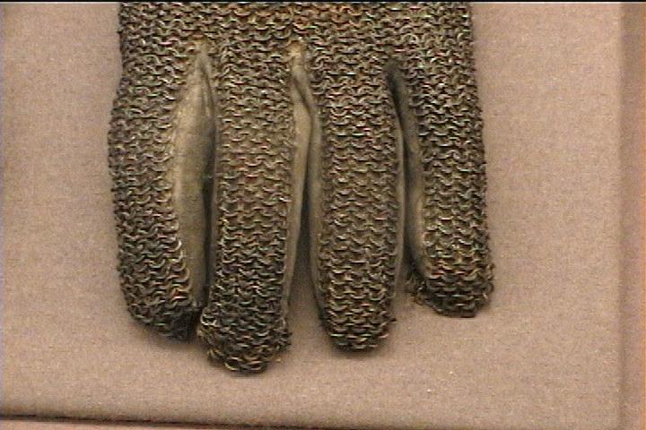

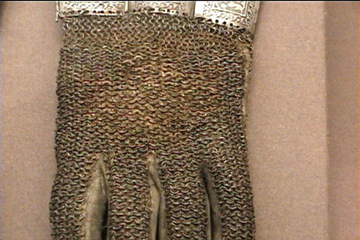

PostPosted: Wed 14 Nov, 2012 12:36 pm    Post subject:         Reply with quote
The weave on the gauntlets should ideally be rotated 90 degrees. That way the expansion and contraction of the links corresponds to the movement of the fingers.
Apologies for not commenting before all that beautiful work had been done. It is a wonderful project.
IIRC these pics are of the duelling gauntlets in the MET. Notice how the weave changes direction up near the wrist. That way the links can be easily attached to the forearm plates but they can still flex properly down at the fingers.

PostPosted: Wed 14 Nov, 2012 1:47 pm    Post subject:         Reply with quote
Wonderful pictures, Dan! Thanks for sharing!!
I didn't know them. Also I understand completely what you mean about the direction of the weave pattern. This really should be better than my way (only in one direction).
Ideally, I should re-work my gauntlets in this way, but I feel very, very reluctant to do the whole work again. Sad
