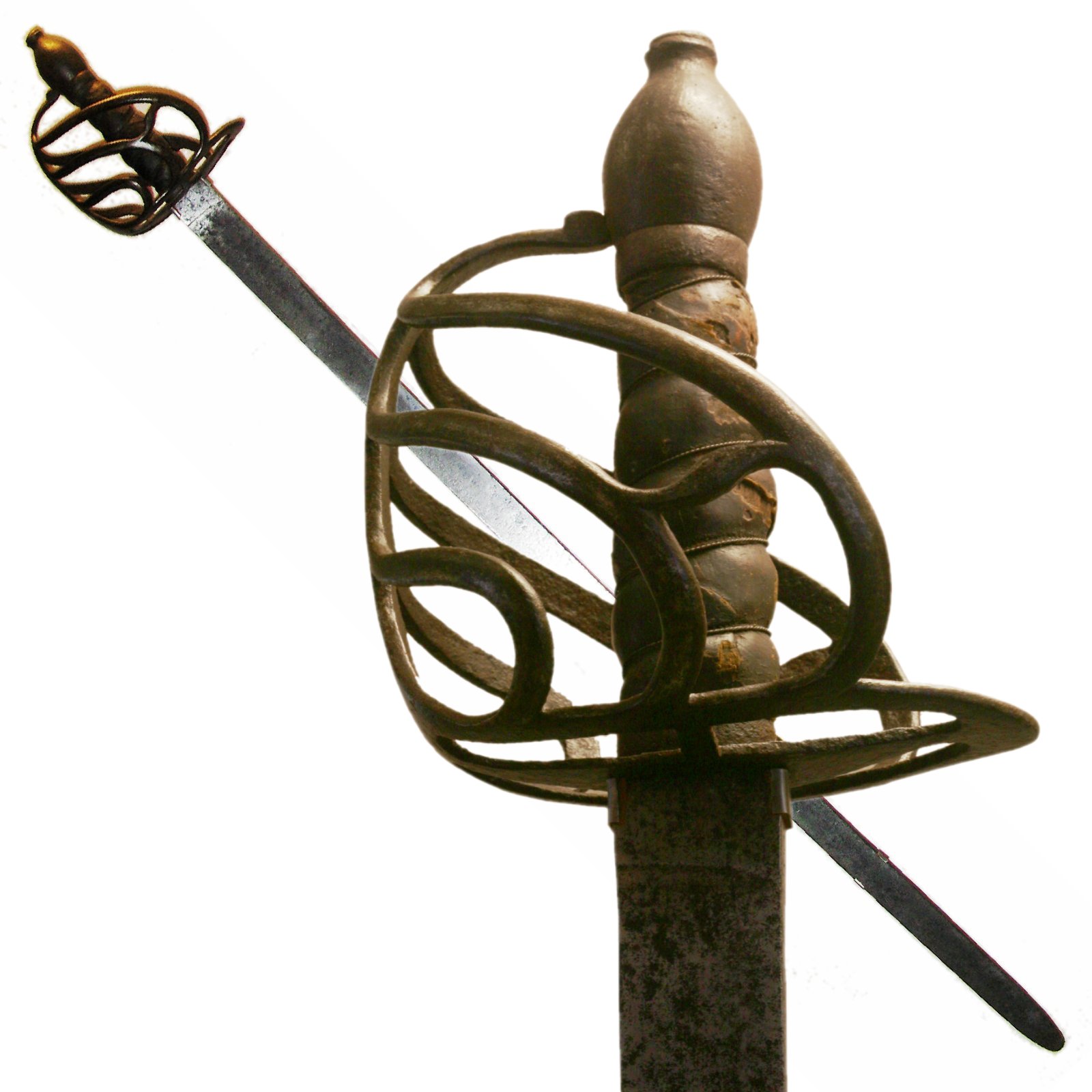

i like very much this two kind of basket hilt,
there are some antique examples featuring a complete basket instead of an half one?
the E.B.E hanger is in the collection of Mr.Chris Goerner, and i'm quite sure that another forum menber has, or at least
have had, in is collection the other sword pictured, i would be very gratefull to them if they could provide some pics of the
two swords.
 Attachment: 61.45 KB
 Attachment: 120.8 KB

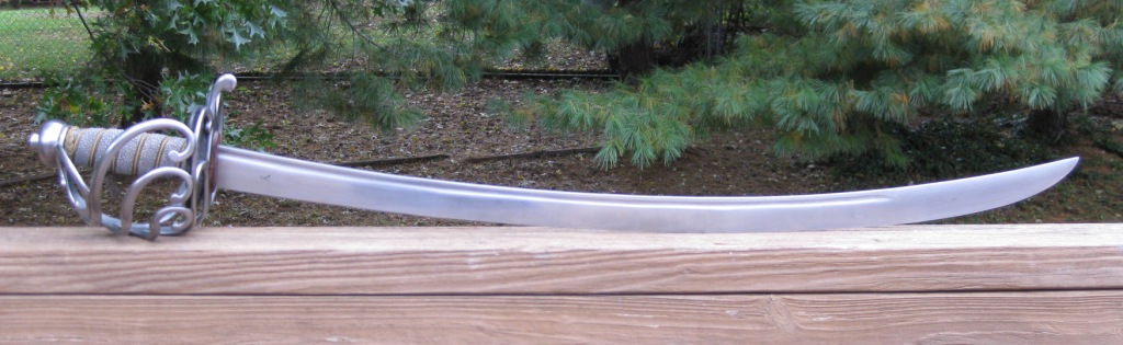

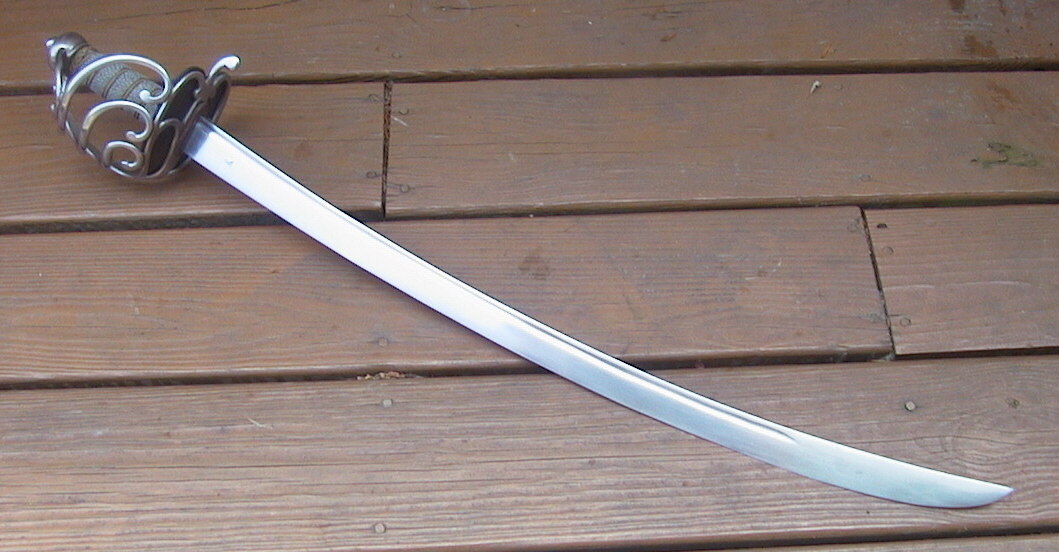

Here are a few more shots of the sword ElJay made for me. I've been having trouble getting used to my new camera, so when I have more time, I will try to get some better resolution photos.
Chris

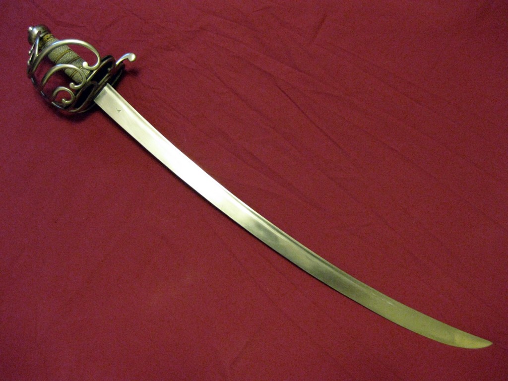

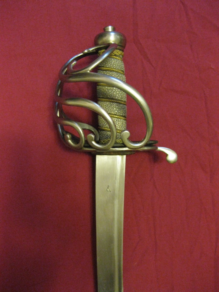

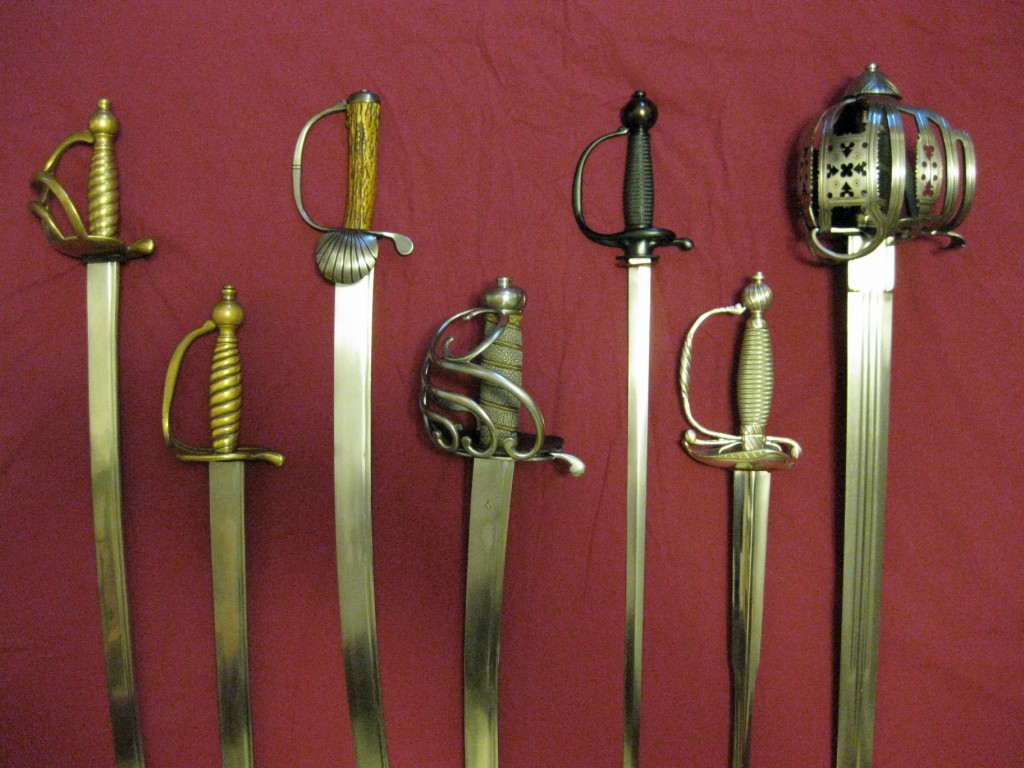

Here are a few more shots I forgot I had.
 Attachment: 139.12 KB
 Attachment: 125.54 KB
 Attachment: 199.6 KB

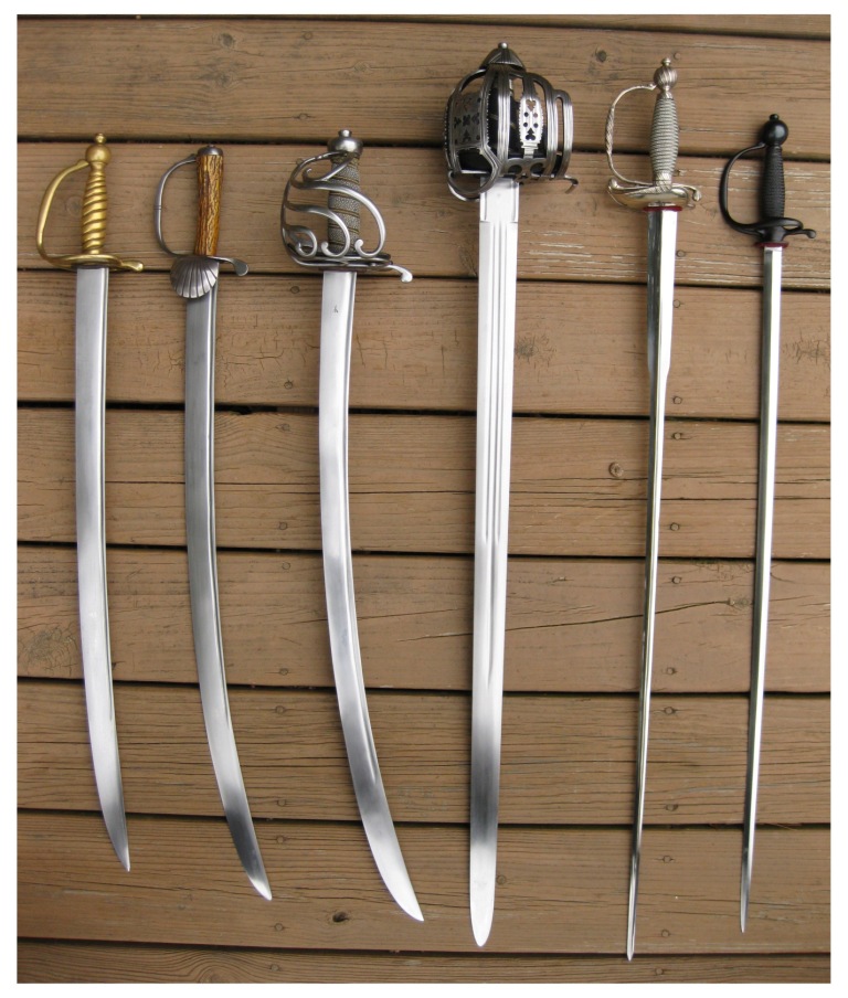

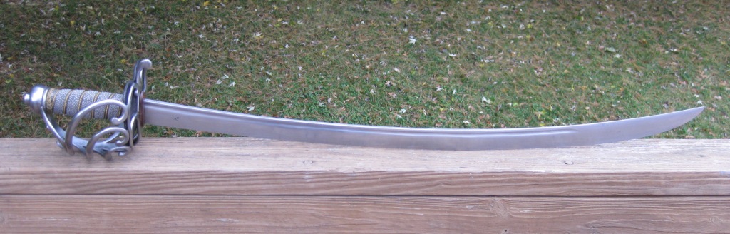

E.B. Erickson
Location: Thailand
Joined: 23 Aug 2003
Posts: 455
PostPosted: Fri 18 Dec, 2009 7:13 pm    Post subject:         Reply with quote
Hello Gabrielle,
In your post of the 16th you included a photo of an S-hilted hanger, and it's a photo of a sword in my collection. Here's some details: Blade about 26" long, single back fuller, marked with the running fox and SH. There is a leather pad at the base of the grip. Grip is sharkskin bound with brass wire and brass ferrules. The hilt is a half basket, and I've never seen any of these S-hilt hangers with a full basket.
--ElJay

Chris Goerner
Location: Roanoke, Virginia
Joined: 19 Sep 2004
Likes: 14 pages
Posts: 356
PostPosted: Sat 19 Dec, 2009 5:01 am    Post subject:         Reply with quote
Gabriele Becattini wrote:
Mr.Goerner i have the same request for you, i'm especially interested to know how such kind of basket hilt compare
respect to a "standard" scottish broadsword/backsword
Gabriele,
I don't do much WMA with my swords, so keep that in mind as it limits the quality of any comments I might make about handling. What I can say is that my hanger is obviously a lighter, faster sword than my baskethilt. The original it is based on had a 28 3/4" blade, overall length of 34 3/8" and weighs 1.6 lbs. The baskethilt, in comparison has a 31 3/4" blade, an overall length of 37 3/8" and weighs just over 2 lbs. The typical baskethilt does provide significantly better protection to the hand, than these half-basket hangers, but at the cost of added weight in the hilt.
I think the real question is how much protection is adequate for the intended use of the weapon. For a foot soldier of the mid 18th century, the musket was their primary weapon, and the bayonet their secondary weapon. The hanger came in a distant third in importance, falling out of use altogether by the end of the century. And considering they were intended to be used against an enemy armed in similar fashion, the protection the half-basket offered was adequate for the job, and superior to the majority of hanger hilts of the period.
The baskethilt seems to have developed out of fashion as much as out of function. At the same time, if I were engaged in a combat against an opponent armed with a broadsword, dirk and targe, I would much prefer to be armed similarly rather than being equipped with a half-basket hanger.
Hope that is helpful. If there are others more knowledgeable on the subject, please correct me on anything I have said beyond my knowledge.
Chris

E.B. Erickson
Location: Thailand
Joined: 23 Aug 2003
Posts: 455
PostPosted: Tue 22 Dec, 2009 4:06 am    Post subject:         Reply with quote
Hi Gabriele,
The S-hilt hanger isn't too heavy, probably a little over 2 lbs, so not even a kg. With the short blade it's light and maneuverable.
Comparing it to Scottish baskets, I'd have to say it depends on the baskethilted sword. I have one in my collection that only weighs a bit under two pounds, so that one is as fast as the hanger. Others are heavier and slower, but usually a Scot basket has the POB only an inch or two ahead of the hilt, so even the heavy ones can still be maneuvered easily. Now there are antique baskets (both English and Scottish) that weigh 3 lbs+, and those are slow. But as long as the POB is close to the hilt, even those aren't as bad as one would expect them to be.
--ElJay
