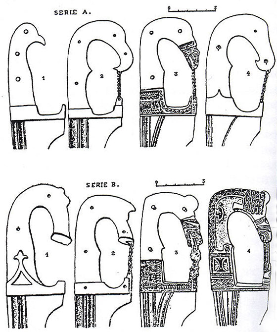

PostPosted: Wed 23 Dec, 2009 12:39 am    Post subject:         Reply with quote
No bronze or brass was used on the falcata (Greek kopis did have bronze hilts, but they are quite different overall). The bolsters are iron, attached usually with two rivets. Below you can see an example where the rivets are drawn (series B, no. 2). The rivets are usually hammered/ground flush, so you don't see the rivets.
Of the organic material, I don't have much information. This example has a white material, which could be bone or ivory (most likely):
I'd expect wood and horn would have been used as well.

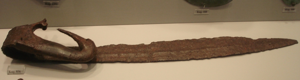

PostPosted: Wed 23 Dec, 2009 1:59 pm    Post subject:         Reply with quote
N.b. here are some kopis examples, of which pictures are pretty rare. Both are from the National Museum in Athens:
