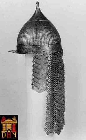

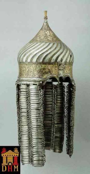

Artis Aboltins wrote:
To tell the truth I have never seen a mix of mail and plates in aventail.
Here are a few examples and my favorite page when I want to look at some oriental armour.
http://velizariy.kiev.ua/avallon/cuirass/kpd/gallery/gallery.htm
(some images don't work on the page itself but can be viewed by clicking on the link above each set of images)
 Attachment: 31.17 KB
 Attachment: 16.7 KB
Ivan
Artis Aboltins
PostPosted: Mon 30 Nov, 2009 10:08 pm    Post subject:         Reply with quote
Should have clarified - meant western european armour in my message, Very nice pictures though.
