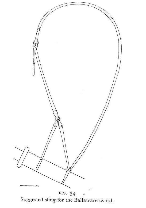

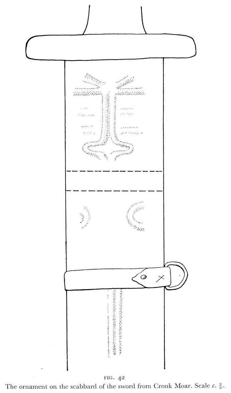

From "3 Viking Age Graves in the Isle of Man" G Bersu, D Wilson.
HTH
N.
 Attachment: 32.71 KB
 Attachment: 58.76 KB

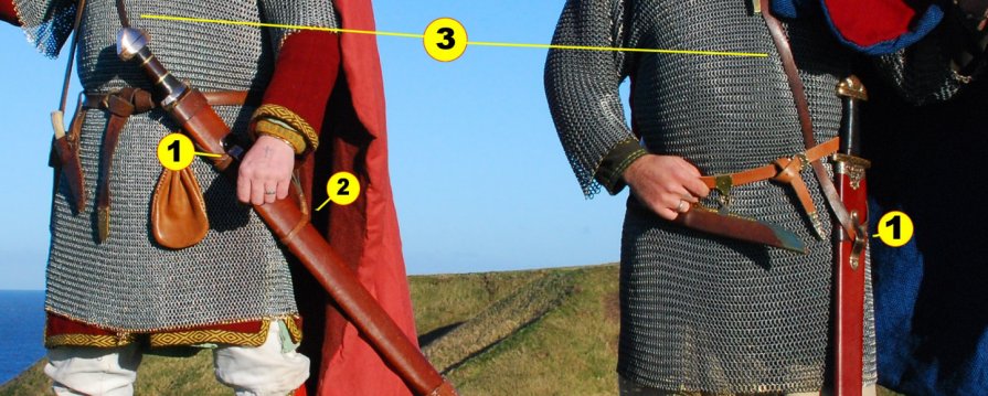

I have attached a photo from my Viking re-enactment kit of my scabbard suspension and one of my colleagues.
Also is a diagram detailing the points that are not readily apparent on the photo.
On the photo, mine is the one at left, with a bronze 'slider' (see fig 1) which is a loop that accomodates the baldric (shoulder strap, see fig 3) through it, looped around the scabbard once then out and up to a 3 way strap divider, easily made or purchased, also from bronze (or brass), this divider has a section that continues the strap up and around the back over the shoulder and down to the front and into the slider , the third section goes to a point further down the scabbard. (see fig 2) Where , the strap is looped around the scabbard and stitched or riveted to itself.
The right hand persons sword scabbard, has the same slider and baldric, but without the strap divider, it should be fairly obvious what happens to the position of the scabbard when using this method.
It hangs vertically and even sometimes ends up in front of the left leg, trust me this is a real pain when trying to walk, but a nighmare when trying to run or fight.
The first method, (with the divider) works much more logically and efficiently. Much like in the illustration from Nathan.
For further detail see my illustration which should make it clear (I hope), The 'Slider' is usually rivetted into the front half of the scabbard when it is 1st made, ie, before it is put together.
Anyway, I hope this helps.
Bruce

Bruce's description of his methed does hold the sword well, but I also wear my sword suspended on a baldric belt and secured by the waist belt/girdle in the same manner as the guy on the right in the photo. The problem that Bruce describes is mainly due to tthe guy having the scabbard to far forward, move it back to fit snugly against the back of the pelvis, resting aginst the glutus (bum cheek) and simply shorten the baldric by adjusting the buckle, this raises the sword scabbard, and keeps it in place. but do ensure the waist belt/girdle is behind the scabbard but in front of the baldric.
I have used this method for many years and it has never let me down, but do experiment and see which method suits yourself best.
