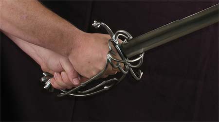

It is very much a combat sword for fighting. While I love the style of the hilt and the detail, they are not why it was made, this sword just feels lethal in the hand and it is designed at all its points to enhance its fighting attributes.
The blade while slightly curved works as an effective longsword blade and allows all the attacks and defenses to work smoothly and very effectively. Even the use of the back edge is fully functional and has some interesting side effects with the majority of it being non sharpened.
The hilt was very enlightening when we actually went to build the piece. It is something you think you know when you look at it in a picture but when the hand is on the sword it is different than one might assume. The side ring with the clover leaf shape precludes the ability to place the finger over the guard. This is something most people want to do. But when held in the hands as one holds the longsword, in the German traditions, it becomes obvious the finger loop is not for the fore finger but rather the support to the bar that protects the thumb on the back guard.
I was working on Roger's sword about the same time when I realized this and started to rethink the whole idea of why a thumb ring is on a sword. It is not so much security of grip or point control. I have always liked thumb rings on swords for these reasons. But rather if one uses a sword with a thumb ring like a messer and you use the thumb ring as a rotational point for the back cuts and sweeping actions the swords begin to sing in the hand and it becomes quite obvious what an advantage such a detail would give the user.
The guard on Nathan's sword therefore offers great protection to the thumb and the outer bars make the hands quite safe in the wards of Pflug and Ochs.
In a way I would call this sword a longsword on steroids. It's not bigger or heavier so much as designed to be more effective and provide better protection than other styles. This of course would be an opinion of the maker and user who choose such a piece but I guess I would be falling in there perspective.

I think if you kept the right hand forward it might work. But if you went to the left hand forward it would not allow the thumb to slide forward. Here are a couple of pics to show how the hands fit. These are my hands and while not big per-say they are not thin Happy
Craig
