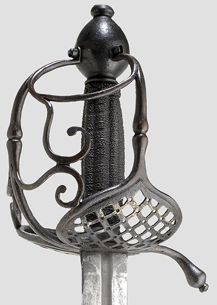

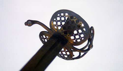

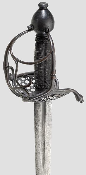

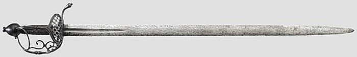

Sometime during the summer of 2008 I was looking at photographs of the auction swords at Hermann-Historica and came across this amazing piece of work. It showed up later at Garth Vincent Antiques, where it apparently disappeared into someone’s collection. I decided that I had to have a version of it, and eventually commissioned Arms and Armor to recreate it. For this thread’s purposes, I’m calling it the HH sword. Pictures of it have shown up on this forum a number of times in the past year, mostly attached by me.
What kind of a sword is it? Garth Vincent called it an English Mortuary sword, which was definitely wrong. All HH would say was that it was an officer’s sword, Flemish or German, from the second half of the 17th century, 38.5 inches overall length.
Cyril Mazansky has a chapter of his book, British Basket-Hilted Swords devoted to this type. He calls them Hilts Based on Side Rings with Pierced Plates, a rather ungainly name.
Other characteristics:
One or more scroll guards, extending from both sides of the knuckle-bow to the side-rings
The outboard side-ring is cusped up towards the pommel, attaching to a side branch which is screwed to the pommel
The inboard side-ring is often smaller, more oval shaped, and usually has a thumb ring (the HH sword doesn’t have a thumb ring, but I asked Craig Johnson of A&A to add one)
This model shares characteristics with other contemporary types. It is somewhat like one half of a mortuary sword, especially with the scrolls. Since Mortuary swords are sometimes called “half-baskets”, maybe one could call this one a “quarter-basket.” It has a resemblance to many 17th century continental military swords (see my avatar) – the lobed knuckle-bow and side branch, the pierced side-ring plates, the thumb ring. Taking all these features from other swords, it combines them to become a unique type. Mazansky writes that only a very few of these swords are known to exist. I’m not sure if he means that few have survived, or that not many were made in the first place.

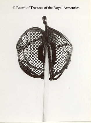

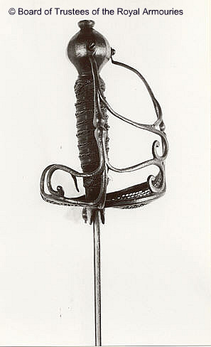

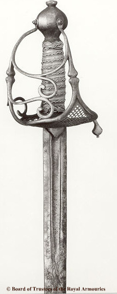

Upon request, the Royal Armouries Museum at Leeds was kind enough to send me photographs of this very similar sword, IX.1248 - German, dated 1660 – 1670. Of all instances that I’ve seen, it is closest in form to the HH sword. Even so, although all features are in the same position, except for the scroll guards it is different at every point – blade fullers, pommel, grip style, branch and knuckle-bow lobes, plate piercings, side-ring angles, thumb ring, and so on.

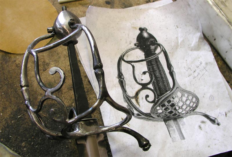

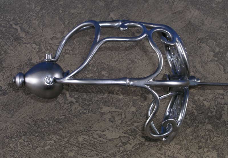

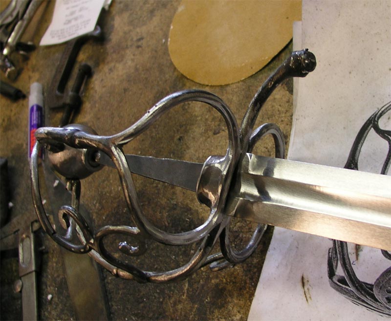

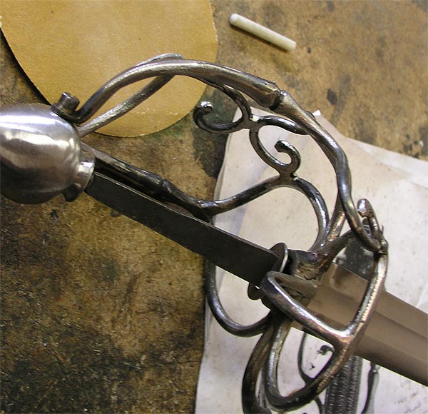

Here are some photographs of the work in progress over at Arms and Armor. You can see what a terrific job they are doing at recreating the HH sword.
Note the small ricasso. I hadn’t noticed it, but they saw it on the photo of the original. This model was unusual in that it lacked a thumb ring or loop, but on my request they found a way to attach one, even though the inboard side-ring militated against it.
There are still a few thing to do before completion, including creating and attaching the pierced plates and bluing the entire hilt, plus lots of finishing off stuff. I will post more pictures as I get them. I believe I’ll have the completed sword in my hand sometime in October. That will be a happy day.

That looks stellar. I'm really loving the original you picked as inspiration and I think A&A is doing a great job so far at replicating it. I'm impressed and will be the first to tell you that I'm quite jealous of your soon-to-be newest toy.

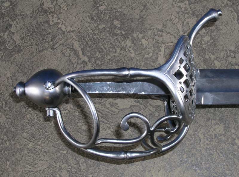

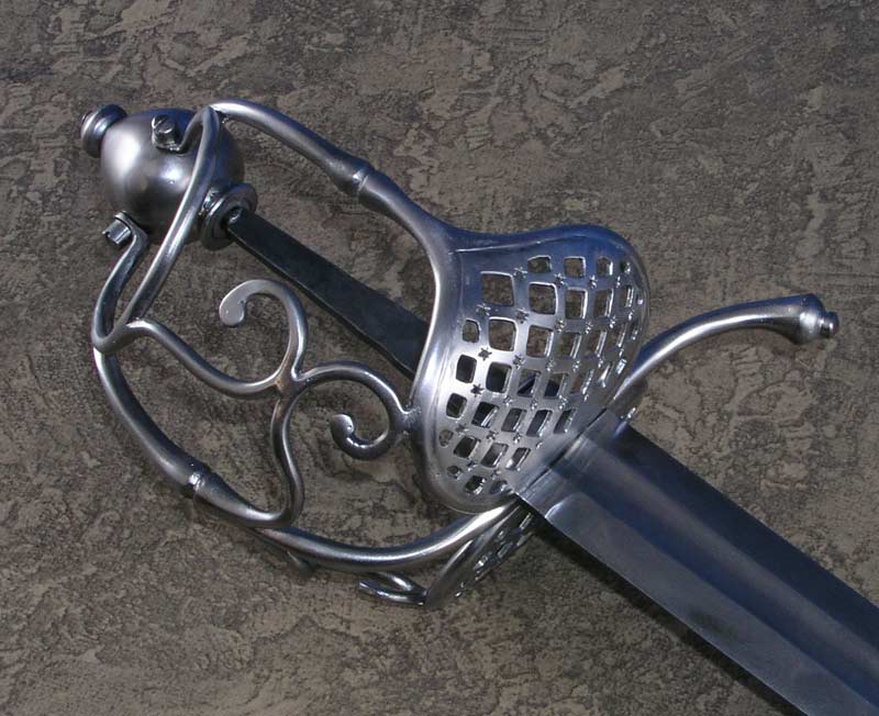

Here are a couple more photos. The plates have been inserted into the side-rings. The star shaped piercings are pretty cool, they give the sword a Walloon flavor.
It isn't quite finished, but they are getting very close.;

Oh, man oh man, I want that, Roger. That's going to be fantastic.

I'd like your opinions on this. You can see the remains of gilding on the pierced plates on the original HH sword. Do you think that having A&A recreate that on their version would have enhanced or detracted from the sword's appearance?

Personally, I like the look of the sword's components as they are now, with the addition of the blueing I think that the final result will be stunning. By putting the gilding on, I feel it may push the sword over the top and may look too gaudy. Just my two cents, but I'm a fan of little to no embellishment.

Josh, I agree, the gilding probably would have made it look a little tacky. Maybe around 1675, gaudy was good.

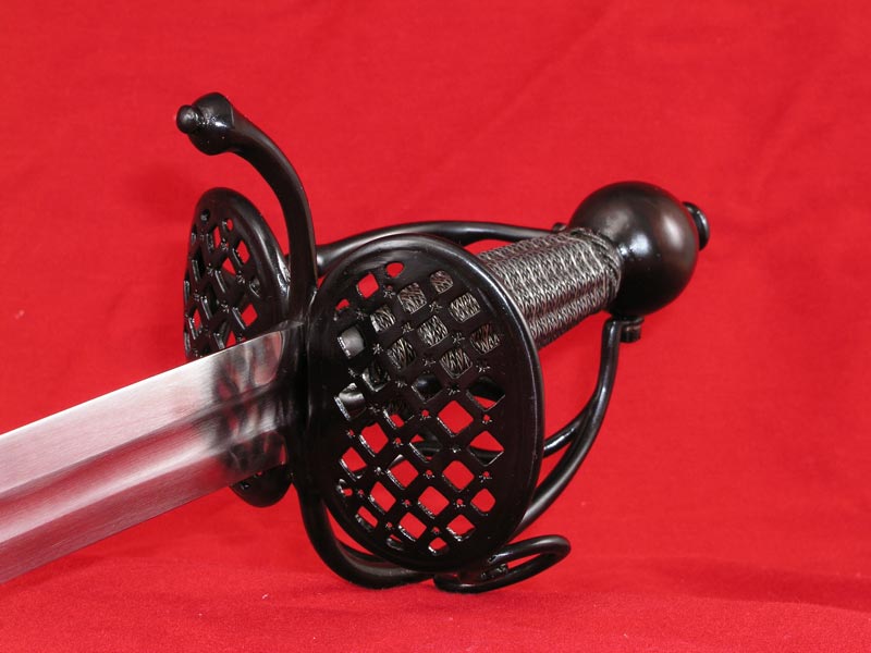

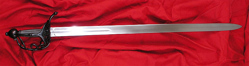

Here are some photos of the finished sword - pretty amazing. Arms and Armor have really outdone themselves. I am really looking forward to seeing this sword in person.

Very very nice!!!
Congratulations

Now this is another amazing recreation from A&A! I love that hilt and the bluing gives it a lot of character. I'm planning to get a custom sword next year (when I'll be 40) and I will undoubtely contact A&A.
