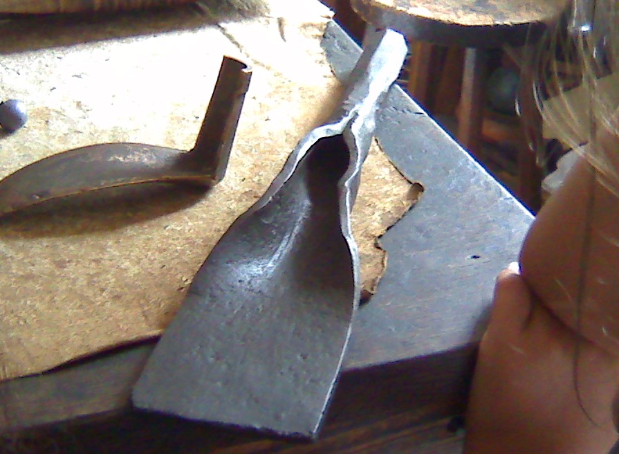

Hello everyone, I was recently at colonial Williamsburg and I have seen a hand forged flintlock barrel which got me thinking about the medieval hand gonne. How were they forged? What ammo did they fire? What calliber were they? I am a hobby bladesmith and I was wanting to try to forge a Hand gonne and not blow myself up. Any info is appreciated. In case your interested I am attaching a picture of the half forged gun barrel at Williamsburg.

This method of forging barrels is one of several believed to have been used. Of course this is relatively late in the game compared to hand gonnes.
I have never studied the construction of hand gonne barrels but would think that they were forged much like the barrels at Williamsburg and ealier; either from iron skelps like those at Williamsburg of the iron strips of some European barrel makers. The problem with these guns, and one reason I would discourage you from attempting this without considerable study and careful experimentation, is that barrels made in this manner are likely to have weak spots here and there which can result in splits and other types of separation that could be potentially hazardous. There is a video out called The Gunsmith of Williamsburg which may be available on DVD by now. In it, Wallace Gusler, the former head of the gunsmithing shop, makes a Virginia long rifle, step by step. The first thing actually produced is the barrel. It is a rather extensive process and very interesting to watch...and it takes a very long time. It will give you a good idea of what is involved in forging even a short barrel and may make you decide not do do it.
Modern muzzleloading barrels are made using two or three different techniques, but all involve starting with a forged steel billet that is much sturdier than anything you can forge weld from iron skelps. And even these guns can occasionally have problems.
Barry's suggestion about joining the NMLRA is a very good one. I have been a member for nearly 40 years and still read the monthly magazine from cover to cover. There are a number of other good monthly publications out there too, but the best is Muzzle Loader Magazine. It is geared toward the traditional shooter and frequently has how to articles.
Good luck with your project, if you decide to tackle it. Just be very careful

Thank you very much! All of this info is exactly what I needed. I am aware that this is exceedingly dangerous and before I attempt any firing I am going to be a very good distance away behind something solid! I was only vaguely aware that modern blackpowder has more power and higher pressures, thank you for the warning. I am now only going to use a recipe of blackpowder that is historically acurate and creates lower pressures.

The Gunsmith of Williamsburg is on youtube! This is the best info I have found so far although it's not a Hand Gonne. The film does however, show a perfect detail of everything involved in forging a barrel, if you know about forging already. It also shows how to proof the barrel safely. This film has given me a very good idea on the basics of forging barrels in general. I highly recommend this film to anyone interested in gunsmithing by hand.
