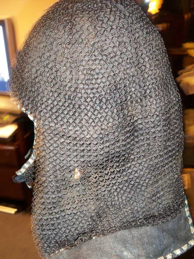

PostPosted: Tue 22 Dec, 2009 12:22 am    Post subject: Butted chainmail         Reply with quote
I have seen many examples of 19th century Japanese chainmail that was completely butted....not just connecting armor plates but full chainmail armor.

PostPosted: Tue 22 Dec, 2009 1:14 pm    Post subject: Re: Butted chainmail         Reply with quote
I doubt that any armour the Japanese made in the 19th century was intended to be a practical defense on the battlefield

PostPosted: Wed 23 Dec, 2009 4:31 pm    Post subject: Re: Butted chainmail         Reply with quote
Dan Howard wrote:
For whatever the purpose it was made, the Japanese produced fully butted chainmail armor that was made to be used in combat of some type, it was not for show or parade purposes but was made as a defence from attack by the weapons of the time.
