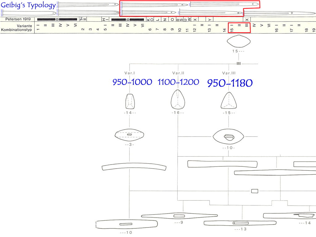

The Albion Europe site gives a date range for the Reeve of 1080-1150. There's been a good bit of discussion in this thread that would favour an earlier "start date" for this sword, but has anyone seen justification for an end date as late as 1150?
Thanks in advance!
Antonio Lamadrid
Joined: 17 Apr 2008
Posts: 91
PostPosted: Mon 19 Jul, 2010 6:45 am    Post subject:         Reply with quote
I think AE’s is the right chronology.
The Reeve has an Oakeshott Type X blade. This type was in use between 900-1130 more or less.
Its guard is a Style 1, common from the Viking Age to the Renaissance.
There are earlier types of brazil-nut pommels, but the one the Reeve has is the Geibig Variante 15-II. It was used between 1100-1200.
So we have a gap of 30 years, 1100-1130, where everything is fine. Give and take 20 years to that date for good measure and we have the 1080-1150 time period.
 Attachment: 147.79 KB
