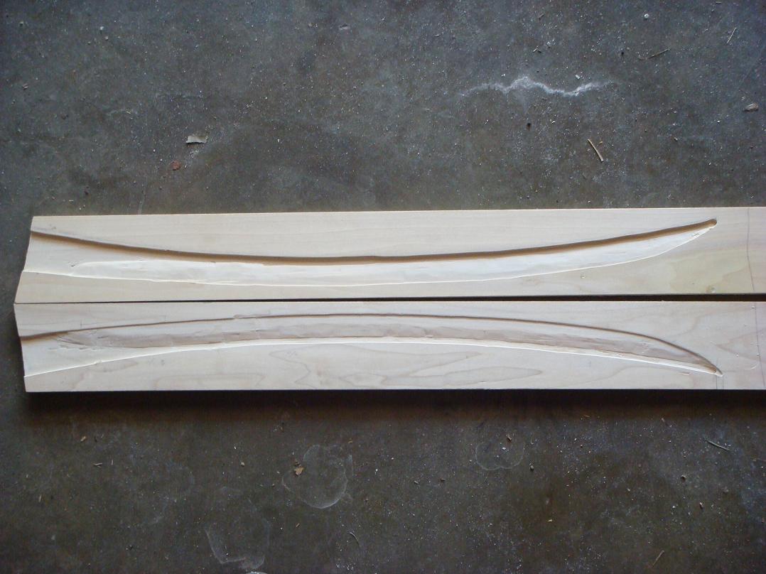

This morning (after another run to Lowes, and cleaning off the garage work bench ) i got the thing carved out, and it fits nice, if not a little snug, but a little more sanding will probably take care of that
Here is pictures of it coming along so far.
Attachment: 120.71 KB
Carved out halves [ Download ]

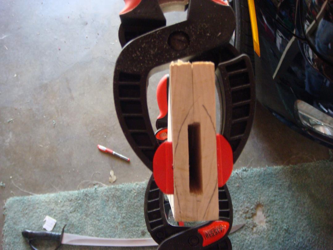

Attachment: 131.44 KB
Point Right [ Download ]

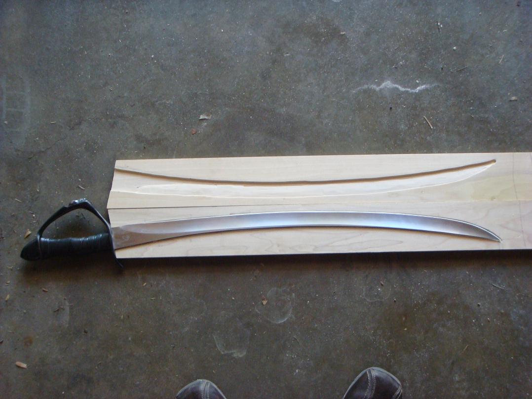

Attachment: 122.55 KB
Two halves together, and the sword it is for. [ Download ]

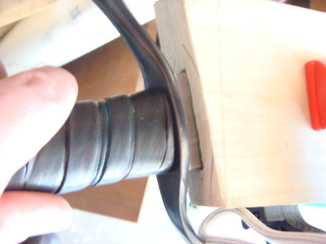

Attachment: 106.48 KB
Throat. I had actually never really noticed that it isn't symmetric until tracing this. [ Download ]

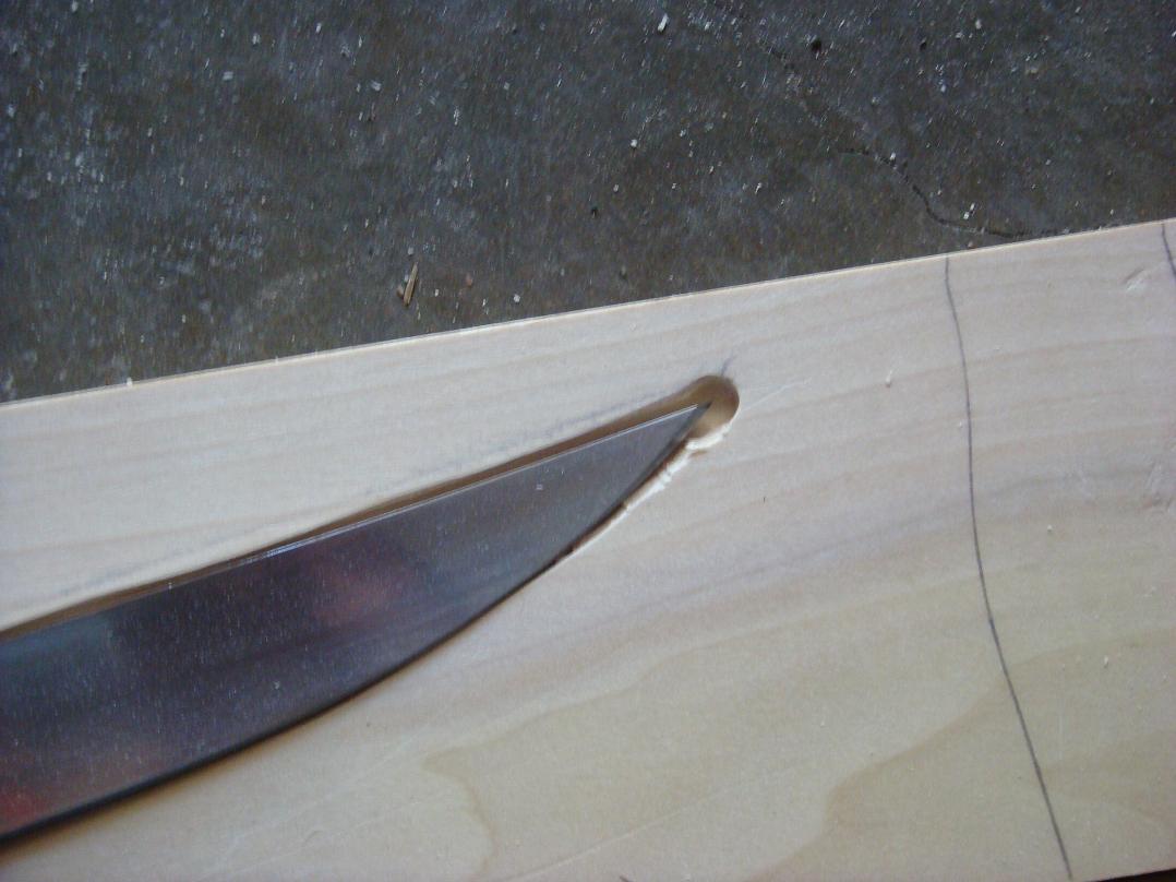

Attachment: 76.28 KB
the fit [ Download ]
