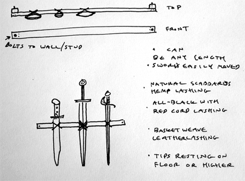

PostPosted: Mon 23 Mar, 2009 2:27 pm    Post subject:         Reply with quote
Thanks for the clarification. The balsa idea intrigues me. Eliminating the leather, I could knock out "safety" scabbards of historical form for my collection much faster than I could make poplar equivalents. I don't do living history, so I don't need stitch-perfect scabbards, but I do need something to keep little fingers away from my sharps. This might be a good solution. I could paint `em or leave them natural and sealed. If they're all alike in finish, it would be obvious that they're just the means of safe display. In fact, I can imagine these kinds of light, uniform scabbards lashed to a poplar supporting frame so that they literally form part of the display. Hmmm.....
Dig:
 Attachment: 130.36 KB
