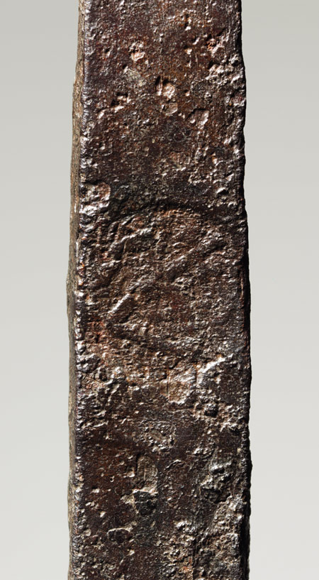

This MET sword is really a nice one.
About the crudity of the first sword... It means nothing. From celtic times to late medieval very fine weapons were made.
