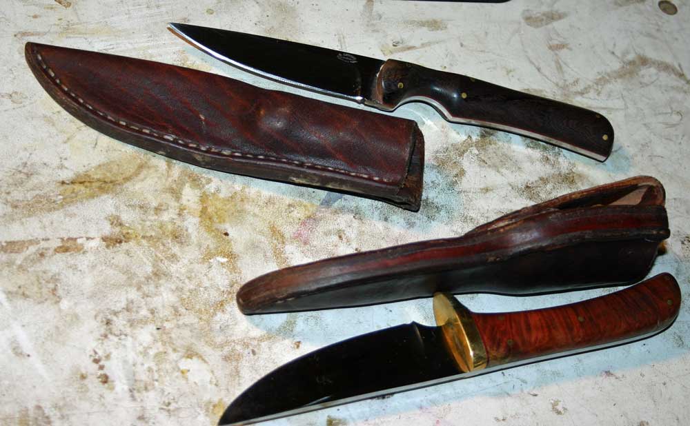

I can't quote any formal reference, but when just leather is used knife makers call it a ""sheath" today. These can be immersed in hot 150 to 160 F (65 to 71 C) wax-oil solution (usually beeswax based, knife or sword inside of it while immersed in the harmless heated oils) and made to dry quite rigid, and surprisingly weather resistant with a long lasting precision fit. The wax-oil treatment seals the leather in a way that leather contact corrosion against a water soaked blade is not a problem. That is actually my own preferred method for a fixed blade utility knife.
Attached, my everyday kitchen, backpacking, fishing, etc. do it all knife sheaths for all weather conditions. These are several years old. (I can't even remember their age.) The guards and contours still neatly "snap" into them and stay firmly placed inside when inserted.
 Attachment: 71.77 KB
