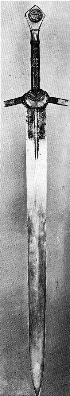

Anyone have pics of how this, or other similar, metal rain guards are attached? From the angle shown in Records the whole apparatus just looks . . . weird.

Might you mean XXII.1 ?

Doggone it. Yeah, I meant XXII.1. For lack of an "I" a thread dies. Lemmee see if I can fix that in the subject line. There we go. Fixed.
I didn't attach the picture because it's in the features section. Thanks, Dan, for taking care of that for me.
It's got a sort of metal rain guard-ly thing. I can't for the life of me visualize how that would fit over a scabbard or even attach to the cross. It's just an all-around odd hilt.
PostPosted: Mon 09 Feb, 2009 8:52 am    Post subject:         Reply with quote
There are several threads about chappes/rain guards here. As far as I know, metal guards (and most leather ones) are simply folded over the cross. Leather guards can be stitched to an extension of the grip wrap but I'm not sure what a metal guard would need, assuming it's beneath the wood of the grip. That should be plenty effective keeping it in place (see ROTMS for clearer and simpler example, with one side of the guard broken off). Contemporary artwork shows a few different forms, as discussed elsewhere on this site. The example in question here appears to be an elaborately shaped and decorated metal version of the type shaped like a clam shell. As for fit, it slides down over the scabbard, like a cap on a pen (albeit with open sides).
Looking more closely, I think the sword has the usual leather chappe, but with the little gorget-shaped plate(s) stitched to it. I think I see stitching holes in the edge of the metal, and the edges of the leather chappe behind.

So you think that's plated leather, eh? Hard to say from a black and white photograph. I'd still like a picture showing what's going on with the cross under there, if anyone's got one.
This is one of those swords that's either hideous or gorgeous. I'm not sure which, but it's one or the other.

PostPosted: Mon 09 Feb, 2009 5:43 pm    Post subject:         Reply with quote
Here is a better photo of the sword:
Kaiser Siegmund and Kaiser Fredrich III, circa 1430/40
 Attachment: 81.65 KB

PostPosted: Mon 09 Feb, 2009 6:27 pm    Post subject:         Reply with quote
That rainguard does indeed seem to have a gorget shaped plate on it as Sean described. Does anyone know if it has one on the other side of the hilt? If so, I wonder if it is one piece of metal covering both sides or if it's two, joined by soldering or by leather. One piece is certainly an option, as shown on that (very) elaborate Italian sword that Nathan posted pictures of, but I'd imagine would be difficult to make in that shape.
PostPosted: Tue 10 Feb, 2009 6:54 am    Post subject:         Reply with quote
Ahhh, much clearer. Thanks, Nathan! What I thought were holes for stitching appear to be rivets. That suggests that there's something under there--leather? Still can't tell if the reverse has the same treatment.
PostPosted: Sat 14 Feb, 2009 9:44 am    Post subject:         Reply with quote
Here is catalogue text on that sword. Maybe it will shed light on the rainguard's construction. Hopefully one of our German-speaking readers can translate it.

PostPosted: Sat 14 Feb, 2009 10:22 am    Post subject:         Reply with quote
As the text is rather long, forgive my translating only the relevant part:
"...Rain leather covered with silver and gold-plated brass..."
The word "beschlagen" suggests a method utilizing rivets to cover the leather with metal.
Interestingly enough, both handle and quillons are described to be covered with horn...
Cheers, Peter
