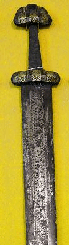

Attached is an image from Arador Armor Library, images of Royal Museum of the Army of and Military History in Brussels, Belgium, by Eli Steenput. Similar shapes dates back to Merovingian era images, but the ornamentation is more 9th century. This particular one is considered Carolingian in origin.
 Attachment: 133.52 KB

What did you mean by that they should be less triangular in geometry and fatter at the debole? I didn't quite understand it. Blush
If you look at the blade, the two sides form a slight but evident triangle, while (earlier) viking blades had the two sides more parallel to each other, at least for most of the blade.
See this sketch for comparison. The blades of B's swords would be better suited to a late gaddjalt type.

I think I understand, you are actually talking about profile taper, right? I agree that the blade is a bit more like later period gaddhjalts but I consider that a minor mistake as blades varied alot in width and taper so this one may not be typical but it is plausible. It can't be perfect for that money, right? Wink
