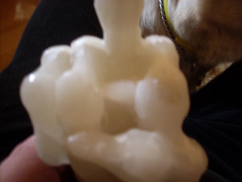

I started my first bigger wax carving project, and being such a megalomaniac idiot, I chose a hammer head, the type which looks like a hand grasping a dagger, sizing it up for a two handed hammer (bit like a poleax, but totally different Laughing Out Loud ). Unfortunatuly, our dog got into the kitchen, and bumped into me, making me drop the piece. But after putting it together again, I saw a possibility there... so I started to alter it to a bit grotesque look, triing to give it a bit of mumificated feel. (totally ahistorical, as far as I know, but considering the danse macabre in other areas of art......... and more importantly, it'll be mine Big Grin )
I can only cast bronze and copper, but I didn't want my hammer to have a bronze blade, so I'll carve the hilt and put a steel blade in there.
The advice I'd need: what kind of dagger should I use? I have my ideas, but there are way too much of them, and I can't afford to make 9999999 hammers.... Laughing Out Loud
Thanks in advance!
(I attached progress pics, I only have about 4 hours in it by now, so it's far from complete.)
Opinions are welcome...

Adam Bodorics
Joined: 15 Apr 2005
Posts: 132
PostPosted: Mon 25 Feb, 2008 6:56 am    Post subject:         Reply with quote
Ahh, I should have been more clear, sorry.
In this case, "dagger" means something that looks like a dagger (hilt, blade profile), but has greatly increased thickness (starting from at least 12mm, tapering to maximum 5mm before tip), hollow grind and reinforced tip. Other thing is, it can be exaggerated in some means, just as the heraldical arrows and the like.
About weight: If it would be casted right now, it would be truly very overweight, but a lot of wax will be removed from there, before I even start the "dagger" part of it. And I'm lucky enough not to worry about weight as far as it's under 8kg total - I used to practice singlehanded sword cuts with a 4kg steel rod, and longsword guards, cuts and thrusts with a 10 kg rod, both being unbalanced and way too long (1200mm for "singlehander", 1500mm for "longsword"). After those monsters a 15kg sledgehammer felt like a feather (probably the heaviest feather in the world, that is) when gripped wide. Big Grin

I think I'll post progress pics today, when I'll have my camera. I removed the middle finger, and remade it so it'll have a top spike as Chris thought. Sadly it didn't turn out as good as I thought, but I'll work more on it. I found that it would be too thin to survive thrust for long (especially when I thrust with full power, adding body weight into it - I'm about 130kg with armour on), so I'll attach there another blade, the end looking like an elongated fingernail, the "tang" passing down to the metacarpal area, to stabilize it a bit. My girlfriend carved a nice looking pommel, but after a bit thinking, I removed it, and placed in the "will someday make something from it" box, as I like more and more the ear dagger idea... I think I'll make a crescent cutout in the "ears", so it'll be four pronged, and reinforce it with small steel spikes placed deep inside. This'll be hard to make, and possibly even less authentic, but at least it will survive use.

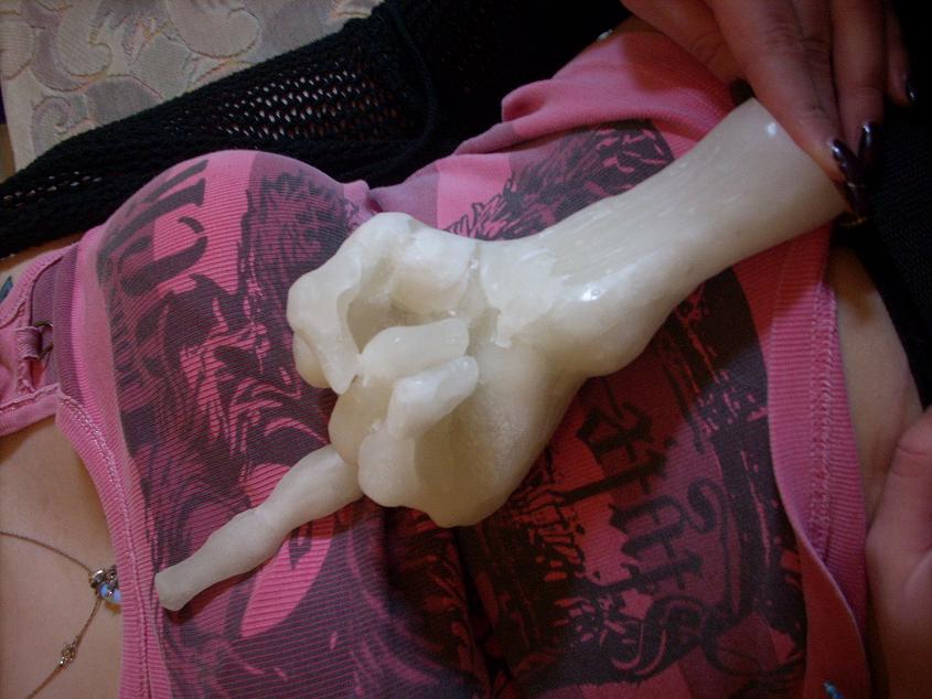

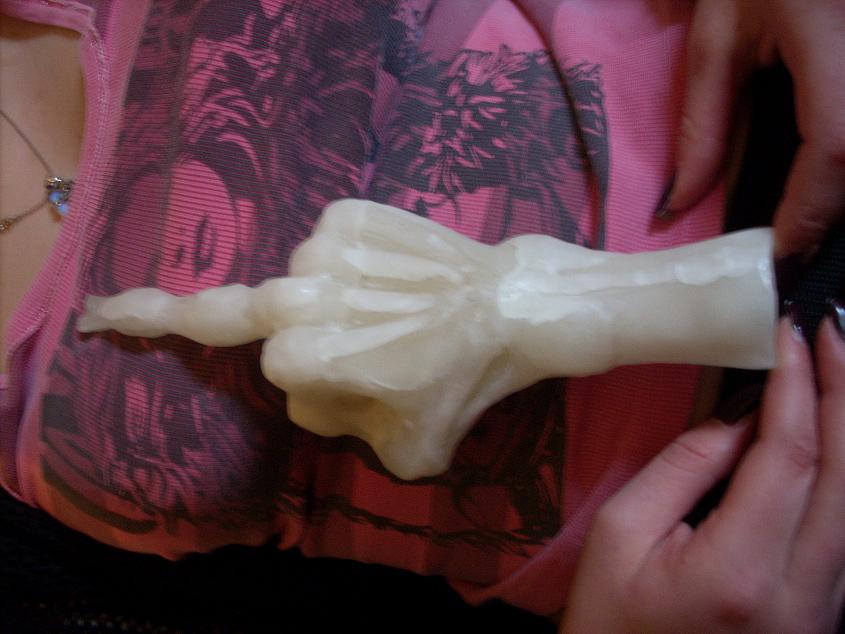

The progress so far...
I'll have to work a bit more on the middle finger, but it keeps breaking apart. Fortunatuly, it's easily reassembled, but it's still a nuisance.
The pictures are a bit blurry, sorry for that.

The visible part of the "grip" roughed out [ Download ]
