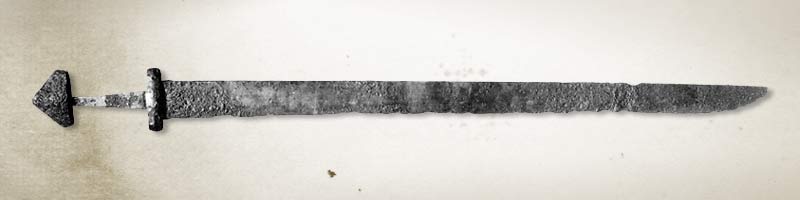

PostPosted: Fri 02 Jan, 2009 10:55 pm    Post subject:         Reply with quote
Please have a look at our article, The Sword Typology of Alfred Geibig where it describes the single-edged Geibig Type 14. You can get a sense of how an authentic single-edged Viking sword may have looked.
