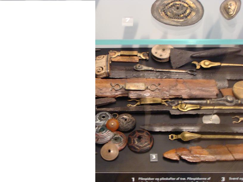

Posted: Wed 17 Dec, 2008 7:29 pm Post subject: |
Here are some originals I will just go through and post whichever ones I see, they are all slightly earlier vendel or migration era rather then viking. All of them are Skandinavian.
Best
Attachment: 44.86 KB
Attachment: 45.19 KB
Attachment: 70.07 KB
