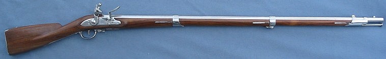

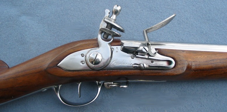

I'm not really a firearms guy, but yours puts me in mind of the French 1766 "Charleville" musket. I'm not sure why the seller thinks it's American. Looks more like a European military piece to me, but then I don't know anything about American muskets apart from reading one book, long ago, about the Harper's Ferry armoury. I'm not sure what an American musket would be doing in Europe. Maybe some modern collector just preferred American arms to the many, many fine European military arms of the period.

What you have there is almost certainly a Charlevillle (French) musket. The brass pan is a dead give away, as are the trigger guard and butt stock shape. The frizzen does appear to be a replacement. The lock, with its double throated cock and small tail at the back of the lock plate is also characteristic of the Charleville. It appears that the fore end cap and barrel band are missing but the photo is not clear enough to be certain. The engraving on the lock plate, only part of which is visible in the photo, appears to start with "Tu.." which is probably Tulle, the French arsenal. Some fowlers were marked "Tulle" and I suppose some military locks could turn up marked the same way.
It is entirely possible that the musket came from the US. The French provided large numbers of them to the Continental Army during the revolution. The first US produced musket, the Model 1795, was based on the Charleville.
The Charleville is quite distinctive so I am 99% sure that is what you have.

I wouldn't be so quick to say its a 1777 (aka Charleville). For one, the barrel bands are not correct. Also, though its hard to tell, I'd say the muzzle is off too.
If it says "Tulle" on the lock plate, then it IS French (or at least the lock plate is hehe).
If it says "Tula" (in Cyrillic), it is Russian, quite possible considering their wars with Sweden. It is not uncommon to find Norwegian and Russian guns in Sweden.
Edit: Here is a Tula lock:
Looking at the rear of the hammer, it is a simple post compared to the rounded knob at the rear of the 1777 (Charleville) hammer. Also, the marking "Ту́ла" looks rather similar to what I can see on your musket (the "Ty" at least).
Here is the whole gun:
As you can see, the barrel band springs are facing the same way as yours, unlike with a 1777 (Charleville). On a 1777 the springs face right, on a Tula 1808 they face left. Also, the trigger is a different shape than on any French military musket I've ever seen.
The muzzle still does not look right though, which leads me to believe it was "bubbarized" by a civilian or by the Government for sale to civilians. You see, what is missing is the bayonet lock, something seen only on military arms. It would be useless on a civilian arm and perhaps was removed to stop its re-use as a military weapon.
All in all, it is certainly not a military 1777 Charleville musket. It is also not American, as a general rule, most guns went across the Atlantic in the other direction. So any in Europe would be very rare, brought back individually by collectors in recent years. Besides this, it doesn't match any American military muskets and it doesn't look like it was intended to be a civilian firearm.
It may be a French musket produced at Tulle (perhaps a trade gun?) but my bet is on it being an 1808 Tula musket which found its way to Sweden in the Finnish war of February 1808 to September 1809.
The springs, lock plate, hammer, bands and stock all point to Tula. The barrel and muzzle are hard to positively identify without more information or pictures.

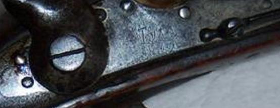

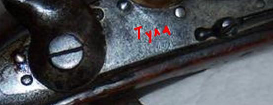

I took the pic and blew it up on my computer screen the lock says TYNA which I think means it is a Tula but I could be wrong. T Y N A that is what it says. I cant show it blown up but here is a drawing.
Attachment: 6.69 KB
Charles Stewart Rodriguez
Chase S-R
Location: New Mexico Joined: 31 Jan 2008
Posts: 166
Posted: Wed 12 Nov, 2008 9:20 am Post subject: |
here is a pic from the original posters musket I just croped
