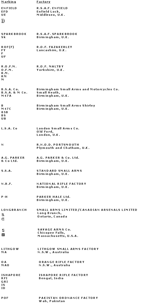

Hi Etienne.
Can you tell me the make of your Lee Enfield? near the date there will be a crown, and makers name. If its a SSA rifle then there wont be any name near the kings crown.
Some of the names may be - BSA.co, Enfield, LSA, Lithgow. If its SSA the SSA stamp will be located where you insert the bolt
at the back of the action.
Photos would really help, can you supply some? We can match the maker parts to your rifle.
Im a absolute 303 nut....
Nick

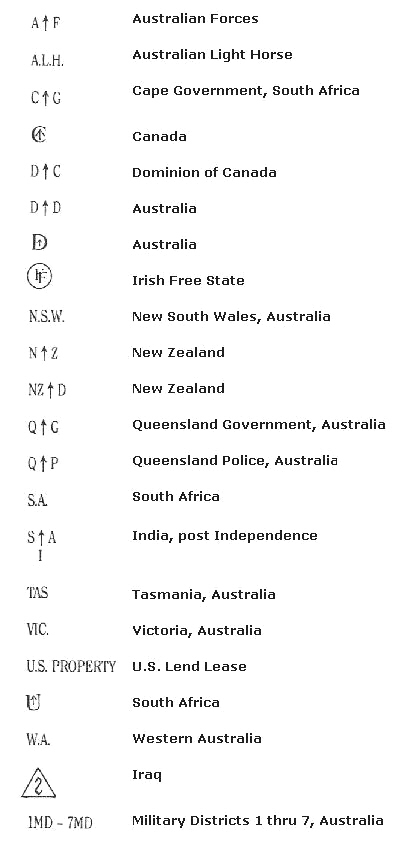

Nick Trueman
Joined: 27 Mar 2006
Posts: 246
PostPosted: Fri 24 Oct, 2008 12:17 am    Post subject: Re: lee enfield restoration         Reply with quote
Nick Trueman wrote:
Etienne Hamel wrote:
Hi all, i have a lee enfield no1 mk3 modified for sport that i would like to restore to military shape. i would like to know where could i find some pieces in good condition in canada or near? i need the forestock, rear and front handguard, nosecap etc...
all help is appreciated.
Hi Etienne.
Nick

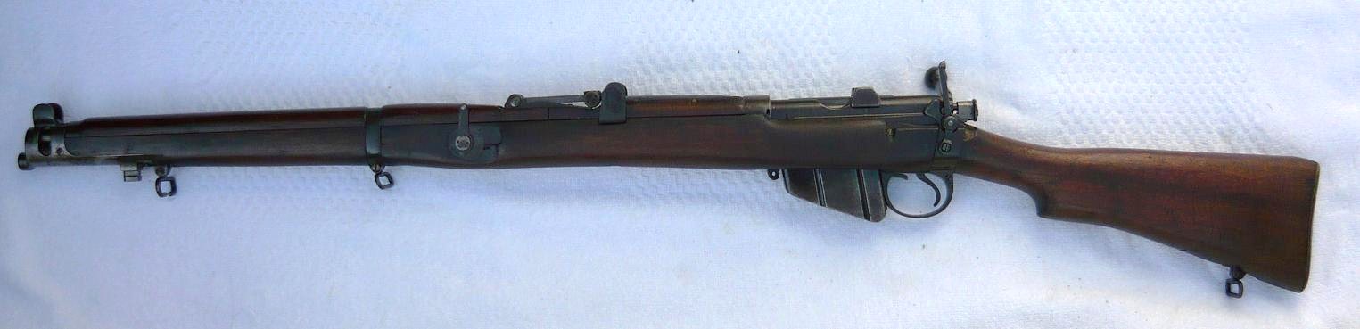

PostPosted: Fri 24 Oct, 2008 12:25 am    Post subject:         Reply with quote
And just to make you cry....Sorry Wink
My 1916 Lithgow No1 MkIII....Matching serial numbers, original 1916 barrel with good rifling. All parts are early Lithgow A in a star marked.
N
