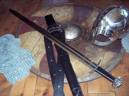

I have been trying to hold off buying anything while I wait for a custom job, but what can I say, I am an addict. So the other day I dropped by Reliks and picked up Windlass' relatively new model viking sword, the 5 lobe. Since there have been so many requests for information on entry-level viking replicas, I will post my first impressions here.
(Hopefully my picture will show up below along with some other viking items in my collection).
I think that the Windlass / MRL description of this sword is pretty accurate; it's a basic looking sword, no frills past the fact of the fairly standard lobated pommel. It is classic in its look, profile, and overall dimensions, and I would say is essentially representative of several historical examples other than minor details of construction.

Windlass 5-lobe Viking pictured with Valentine Armory Spangenhelm and Beowulf & Grendel Shield

Posted: Wed 22 Oct, 2008 3:43 pm Post subject: |
Picture loaded. The handle is not that shiny looking -it's just the flash.

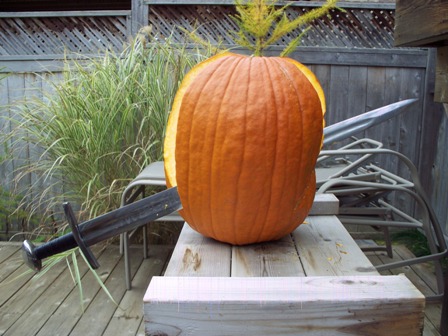

Just for fun, here is a non-scientific comparison of the Windlass 5-lobe, Sticklestad, and Ulfbert cutting through a pumpkin with a 52" circumference. In each case I aimed a downward slice from the right shoulder, taking one step. Then rotated the pumpkin to get a fresh cutting angle until it was destroyed. None of these swords are sharpened.
For reference: in my hands, a 1&1/2 hand war sword will shear right through a pumpkin of this size, whereas a light cut-and-thrust will go about halfway through.
First Cut: the Sticklestad. Pretty clean cut of 31" circumference, but veered off course slightly near the end. Seemed like the cut entered near the optimal striking point, but the tip did not have enough weight to carry through.
Attachment: 62.59 KB
Sticklestad

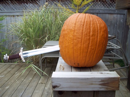

Posted: Thu 30 Oct, 2008 3:16 pm Post subject: |
Third cut: Ulfberht
The overall penetration was a bit deeper, with a circumference of 33". Again, the tip failed to follow through. The big problem here (hard to see from the picture) was that about halfway through the cut I felt a strong torque on the sword, lost control, and it veered strongly to the side. Have noted this previously on swords with wide, very flexible blades.
Attachment: 67.08 KB
Ulfbehrt
J.D. Crawford

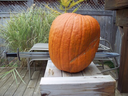

Posted: Thu 30 Oct, 2008 3:29 pm Post subject: |
2nd (shown), 4th, and 5th cuts: the 5-lobe
These gave the deepest cuts, 36" (shown), 37", 38" circumference, finally bottoming out. In each cut the sword penetrated evenly (i.e., the tip following through), cut straight, and imparted a solid chopping feeling like an axe cutting through...well a pumpkin.
The winner!
Again, none of these swords are sharp, so their performance here is likely a function of speed, mass distribution, and blade geometry. Sharp blades against lighter targets, e.g., water bottles, could very well give a different comparison. I would attribute the better performance of the 5-lobe against this medium to the properties mentioned above in my mini-review, as well as near-parallel blade giving a greater weight toward the tip. One can see why Vikings would like this type of blade configuration for chopping through shields and light armor...despite the cost in handling characteristics.
Attachment: 64.71 KB
5-lobe
