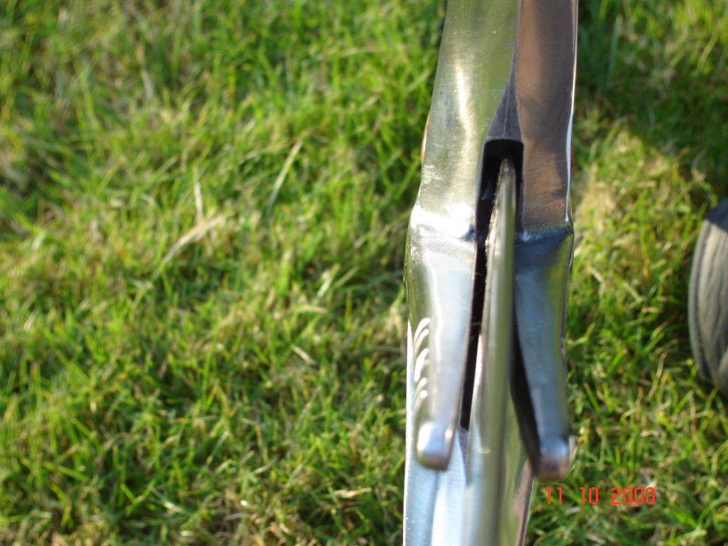

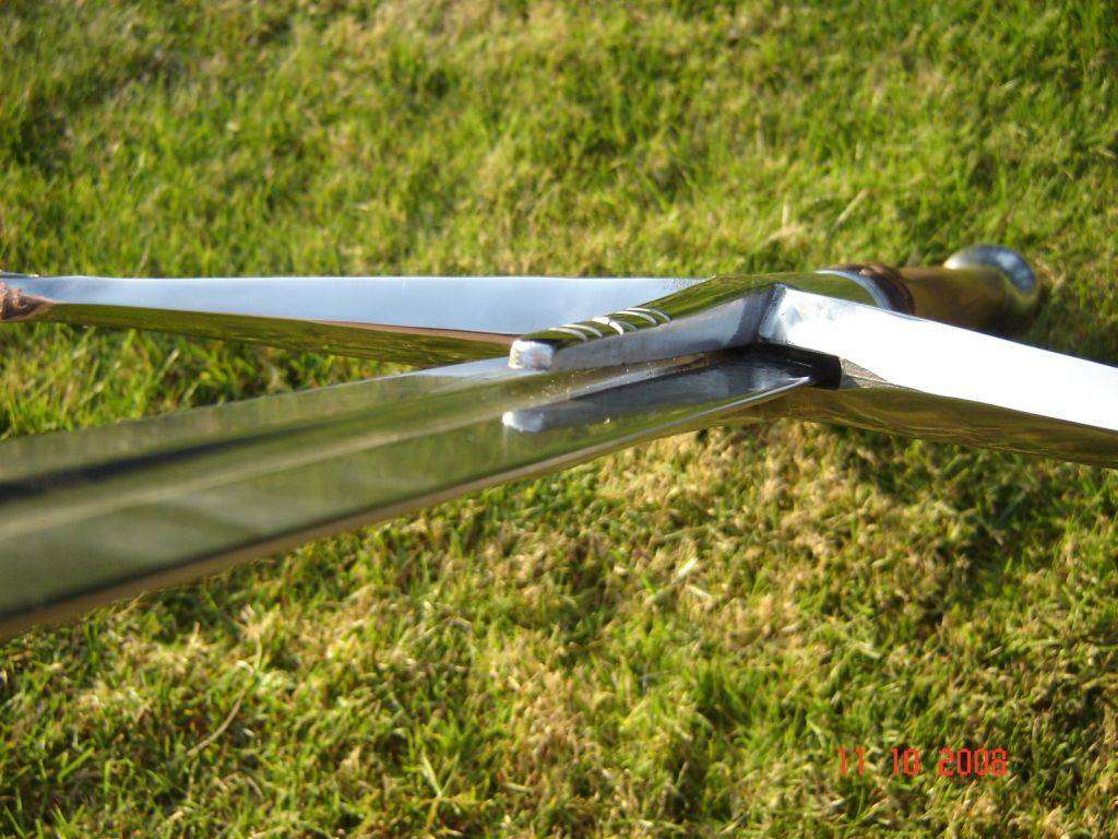

I owned a Del Tin Claymore and its blade sagged under its own weight when held out straight. Somewhere on this forum, there is a picture of Thomas MacDonald swinging the A&A Claymore heused to own. The blade was in mid-swing and noticeably flexed.
Here's the thread: http://www.myArmoury.com/talk/viewtopic.php?t=4781
It discusses gaps between langets and blade, and shows originals with gaps. It also has the pic of the A&A claymore in action:
So the langets not being flush with the blade is not uncommon on repros and originals and may be fairly normal/typical. At least 2 other well-known makers (Del Tin and A&A) have blades that can sag and flex, too.
I don't know exactly how much gap and flex yours exhibits, but it's possible (I think probable) the features yours has aren't unusual.

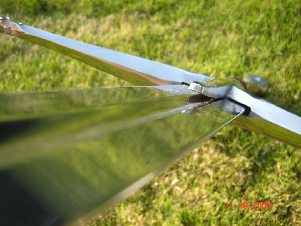

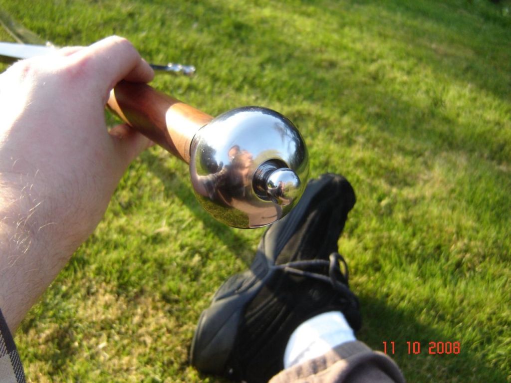

Here are a few images. I hope the links do work.
Hmpf of course they dont. Waffleimage doesnt allow external links any longer.
Okay I am attaching some images I resized them and increased the compression rate. I hope they are still half way acceptable.
I have tried swinging the sword a bit today in the garden and gave it some smacks against Mr Dummy - my pile of old car wheels (without the inner metal frame). And speak about vibration. My hands are a ocean of blisters. Might be training though. However the bend is really intense and.. it rattels. I whole heartedly agree at this point to what was posted above. "They do not <feel> right." I will experiment some more tomorrow and add some more pictures.
I have an Arms & Armour claymore in the works (waiting for its delivery but as that has to go though german customs that will be a while) to compare it to this one.
Right now i honestly have to admitt its not what i had imagined. Maybe i didnt do enough research. I had hoped for a stiff sword with tight fittings. As the pommel looks screwed on i will see if i can dismantle it to take a look at the setup.
Thanks again to all for the feedback. Especially the link was an interesting read.

PostPosted: Sat 11 Oct, 2008 12:43 pm    Post subject:         Reply with quote
The langets don't bother me. They really aren't supposed to be touching hte blade. Swords that I've seen that have them touching end up making an odd "squeaking" noise when used.. There is almost always a space between langets on these types of swords and the blade itself and I imaigne this is how AC intended it to leave their shop.
