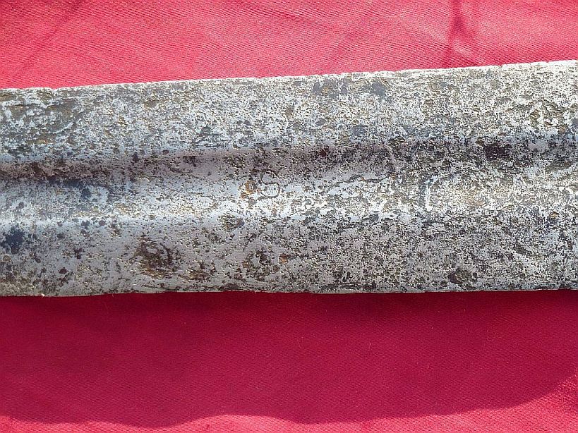

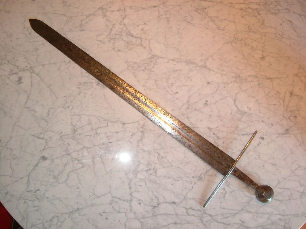

has anyone idea of the kind of typology this sword in attach must be attributed to?
Has a mark as a capital S with splitted ends at the forte and very long quillons ( 27 cm guard on a 90,5 of total length from point to tip).
The blade appears to have been recut at the point , but probably not too much as length.
Seems to me from the second part of the XIII century and was found in a marble grave in a church in Tuscany many years ago.
Has been stabilized and the unstable patination ( very aggressive ) has been removed to the very "salt and pepper" level of patination.
Any comment and suggestion would be appreciated.

Interesting sword!
Because of the proportions of the hilt, I think the sword is of a rather early date. Impression is that it might be 12th century. If so, the pommel is an early example of its type. Not extremely so, but a brazil nut pommel is more commonly found on swords of this type and date.
Blade type might be possible to pin point according to the Geibig typology, as does the guard.
Nice to know that this sword has a certain provenance. There are so many fakes on the market today. To my eyes it does look authentic, but that is famously difficult to judge from photos alone.
I would love to learn more about this sword. It fits right in with time period and type to a current line of research.

Is the "s" at the forte inlayed or are there signs that it once was?

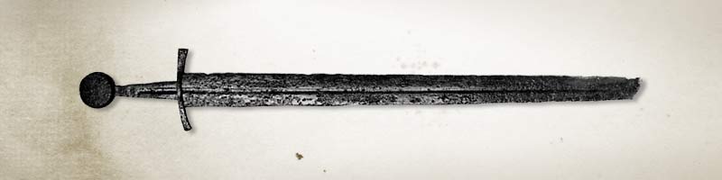

How about type XIa?
This type is very uncommon - In Oakeshott's Records there is only one example. It is characterized by a broader blade with a narrow fuller. Perhaps the fuller on your example is too wide.
 Attachment: 13.39 KB
XIa

What a magnificant sword! For what its worth, these are my thoughts:
Blade reminiscent of Geibig 10a, but too short. Formally I would call it Oakeshott type Xa which puts it at an earlier date. However, if you ignore the long fuller its profile is very similar to some of the wide XIII swords of 13th-14th century. In reality there were transitional forms like this between what we call Xa and XIII. In classifying XIII swords, Oakeshott himself often ignored the fuller length and went with the overall profile, so some days he might have called this sword an XIIIb.
Long type 1 cross appears with some earlier type X swords but was also popular in larger central European warswords of 13-14th century, and appears even later on bastard swords, so that's not much help.
Type I pommel popular in 13th century but appears earlier. The short handle would tend to suggest earlier.
This is just one of those tough ones that could go either way, but on the safe side one might vote for early 13th century.

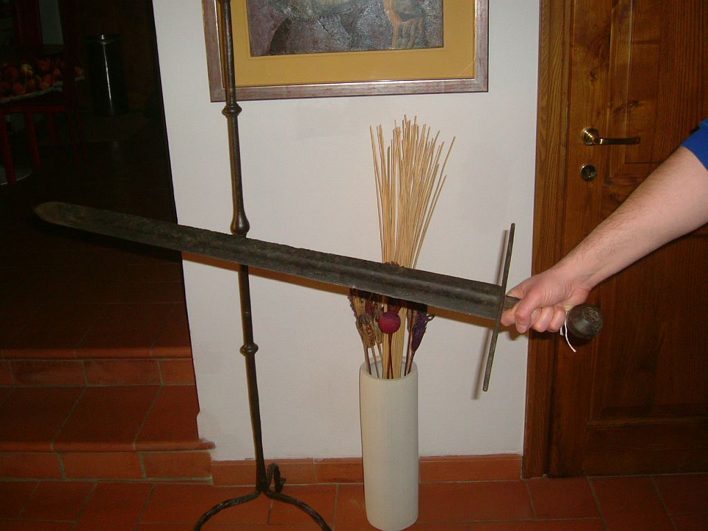

-I attach an image of the earlier state when I found it, just after the stabilization and the removal of the glossy layer of the patination, and again sorry for the image but was intended to show the proportions on hand ( I must say that it's still very balanced, even if a part of the point seem to have been removed).
I'll try to give you all the best informations I can, so be patient if I'm not so professional in my descriptions.

- Yes the mark appears to have been inlayed probably in gold, there're some remnants inside and they're too shiny to be brass, but that's my impression.
The fact is that it was inlayed certainly and not in copper and that on the other face I didn't find any certain trace of another symbol, but probably due to a lesser preservation in the same point....

Really interesting, and a great picture of the sword "in hand."

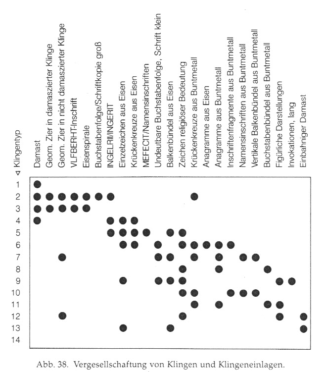

I think that Geibig typology is in this case more useful than Oakeshott.
Since Geibig lists clear definitions of his types by proportions, it may be a good idea to measure the sword if possible.
Geibig distinguishes (page 83):
- Fuller length
- Fuller width
- Fuller taper over the first 40cm from the guard
- Blade length
- Blade width
- Blade taper over the first 60cm from the guard
- Fuller length / Blade length ratio
- Form of edges and point
I've also attached a matrix linking Geibig blade type and inlays.
 Attachment: 187.3 KB
