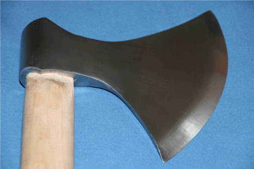

Its a gift to Mike Stillwell, who gave me a rediculously huge (ie totally awesome) Kukhri when I was in London.
May be a bit inappropriate for the forum, since its based on a movie weapon, not a historical one. If so, I apologise for spamming. Happy Still, a pretty useable shape, I'd say.
The blade is mild steel, edge not hardened.
http://www.fioredeiliberi.org/phpBB2/viewtopic.php?t=9344

Looks great, Einar. I take it that you forged it out yourself? You could have welded a piece of higher carbon steel between the layers of low carbons steel to give it a cutting edge. Another way to have done it it fold the high carbon bar in half length way and forge weld it over the the low carbon steel.
Hi, Doug. Its not forged. I simply heat a length of 4mm sheet steel, bend it around a bar to make the socket, then cut the blade out of another 4mm piece, weld them together, grind, down the welds, polish, and blacken. Its a very simple method, but takes some time nonetheless.
I use mild steel because thats the only thing available at work, but I plan to get hold of some flat bar stock of high carbon steel that I can forge to shape and weld to the blade.
I could in theory try to forge the entire thing, but I doubt my boss would be thrilled about me using the oxy-acetylen torches for hours on end for private means. Big Grin

You did a real good job of grinding and polishing the welds because I still don't notice them. It still has a very good appearance and there are probably several reinactors out there that wouldn't mind carrying it as a prop.
