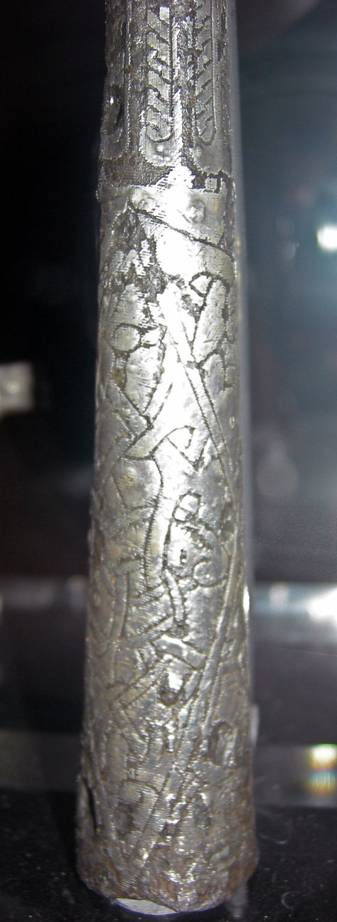

I've seen pieces in the local Historical Museum (Stockholm) with the non-ferrous decoration in a similar "clean" state, so it shouldn't just be something done by dealers to increase the value. I would hope that they didn't need to use anything too aggressive to restore the decoration to this state either. I'd also guess that the more aggressive cleaning methods wouldn't have left the ferrous parts quite as patinated as they were.
 Attachment: 80.15 KB
Close-up of a viking sword.

Great pic! Do you have any more like it? If yes, please post them!!!!

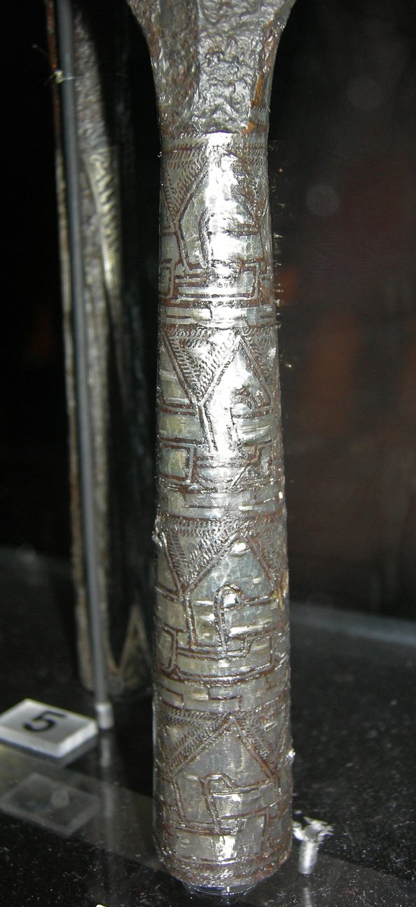

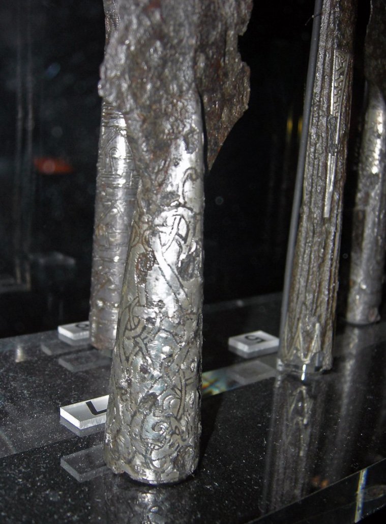

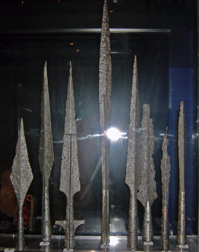

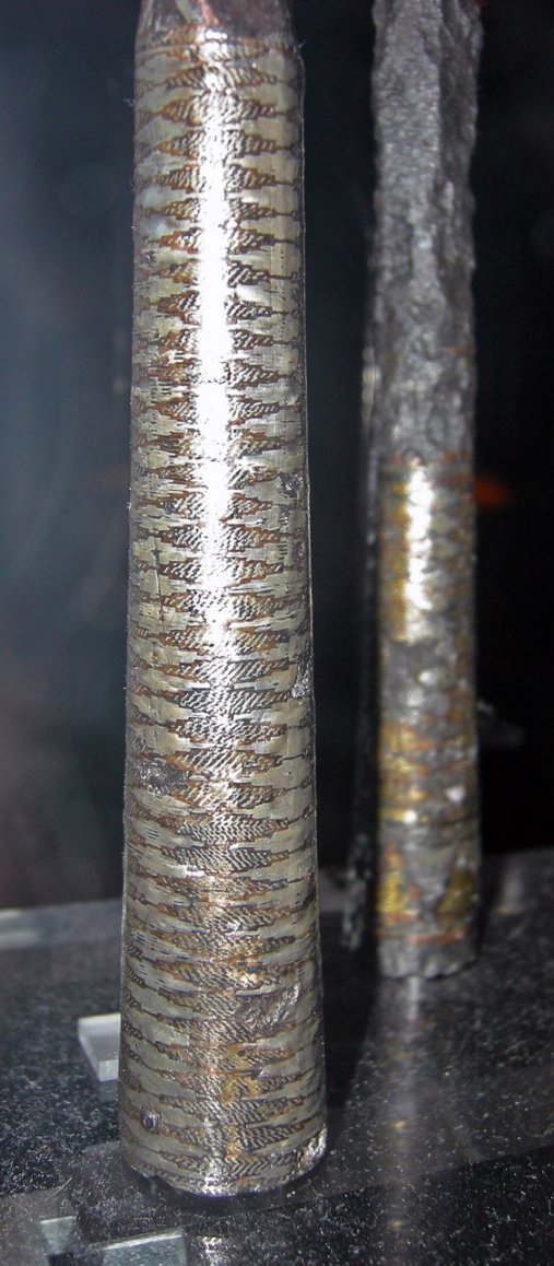

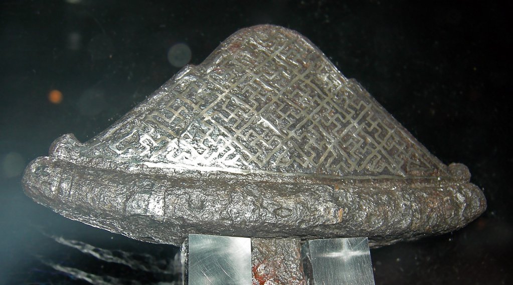

Kjell Magnusson
Location: Sweden
Joined: 10 Jun 2004
Posts: 123
PostPosted: Sun 10 Aug, 2008 10:31 am    Post subject:         Reply with quote
Tim Lison wrote:
Kjell-
Sure, here's a few more pictures (basically those which turned out somewhat decently) from that museum trip, of relevance to this thread. All of it viking stuff.
 Attachment: 115.12 KB
 Attachment: 135.32 KB
 Attachment: 139.93 KB
 Attachment: 117.36 KB
 Attachment: 135.25 KB
 Attachment: 107.86 KB
 Attachment: 137.15 KB
