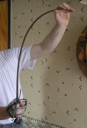

I think a light falchion would make a terrific slicer!
Here is a picture or two of one made by Vladimir Cervenka;

Richard, that's a wounderful sword. I wander how it handles - weight, balance, "feel" etc. I had a chance to handle one of Del Tin's first Dusscks which is basicaly very similar, it felt too heavy to size and the hilt was narrow for my average+ hand. Fit and finish were superb, though.

That certainly seems like a thin blade, I bet it is very light and fast. I would worry about it's sturdiness though. It seems like any resistance would fold a blade like that over...

Rusty Knorr wrote: | That certainly seems like a thin blade, I bet it is very light and fast. I would worry about it's sturdiness though. It seems like any resistance would fold a blade like that over... | Thrust me, a blade that can be bent like that and return true won't be bend out of shape by anything less than smashing it against a rock over and over again.

Sa'ar,
I don't have details on this one, but have asked Vlad.
If he sends me further information I will pass it on.
I know he spends a lot of time in museums measuring originals, so it'll most likely be extremely close to one he's seen

Vladimir got back to me re. the falchion.
He says that he has heard a review might be coming up of this sword here at myArmoury!
Regarding measurements, Vladimir has not got anything specific. He made this sword three years ago and has no recorded details.
He did offer approximate statistics as follows;
Blde length..................700mm
O/all length..................895mm
blade width, @ hilt.....43mm
blade width near tip...50mm
weight...........................1080 grams.
