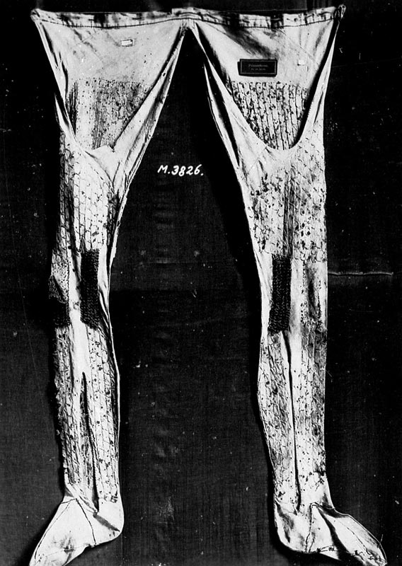

Speak to me of panzerhose. Tell me everything.
I assume they're mail leggings. Are they quilted?

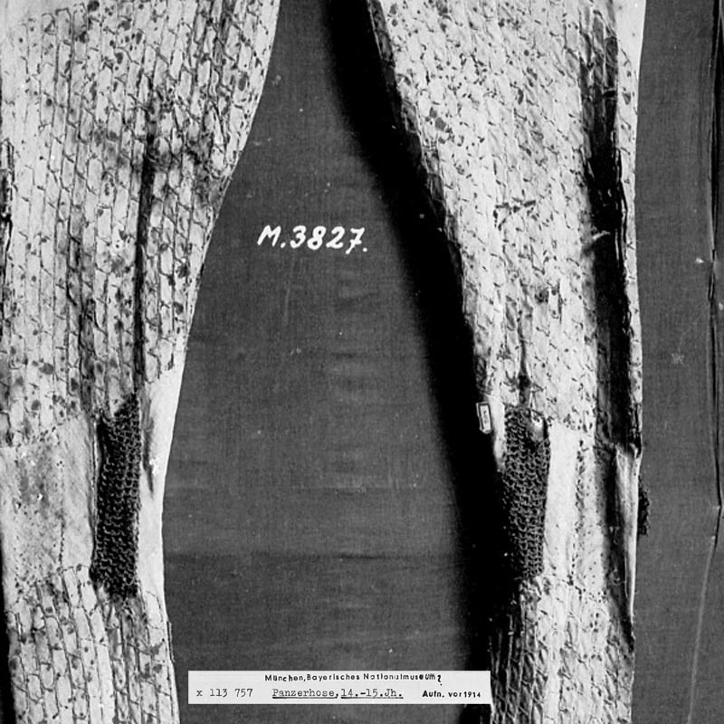

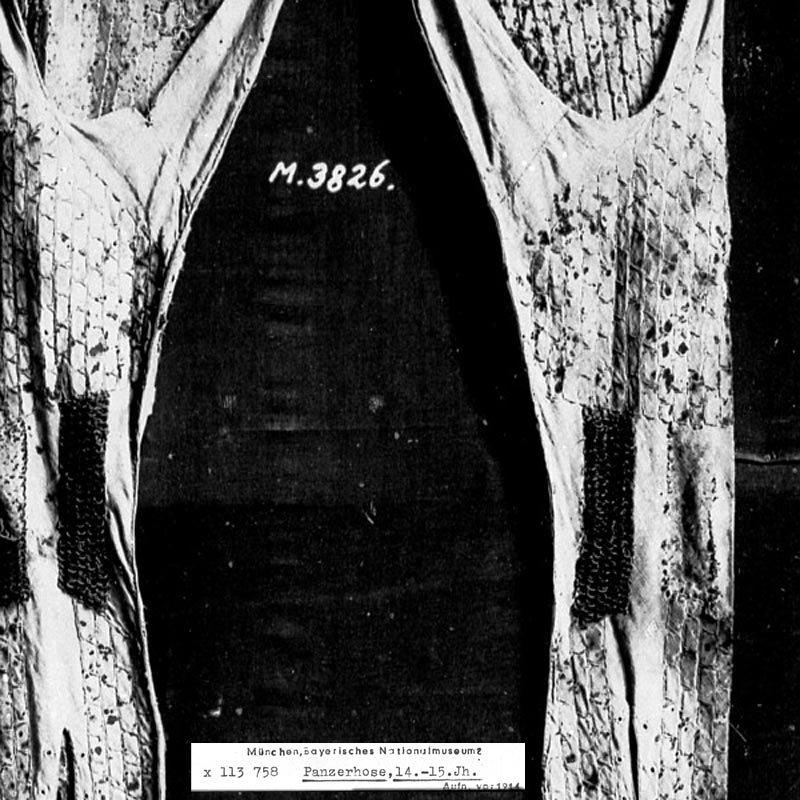

Attached are two 14-15th century examples found at the Bayerisches Nationalmuseum, München.
Are they simply cloth/quilted hosen with mail gussets? Is there mail covering other areas other than just the backs of the knees?
 Attachment: 122.66 KB
Panzerhosen found at the Bayerisches Nationalmuseum, München
 Attachment: 102.25 KB
 Attachment: 125.35 KB
 Attachment: 100.74 KB
Torsten F.H. Wilke
Location: Irvine Spectrum, CA
Joined: 01 Jul 2006
Posts: 250
PostPosted: Fri 08 Aug, 2008 10:12 pm    Post subject:         Reply with quote
Seems like they might have had more mail sections around the knee area at one time, instead of that solitary patch behind the knees. Does anyone think there are some sort of small metal plates covering the leggings?

I have always thought it refered to mail leggings but cannot recall having seen any pictures of existant ones before so this is a first. I wonder if closer views might not show if at one time it had more mail. I suppose though that it could be both a fully mailed hose or just like gussetted hose and still retain the same name.

Encountered this very subject several years ago. If I recall they are hosen or leggings worn under plate armor for the legs. The mail would at the opening to span the gap between the top and rear part of the greave and the hinged plate(s) protecting the outside and rear of the thigh.
