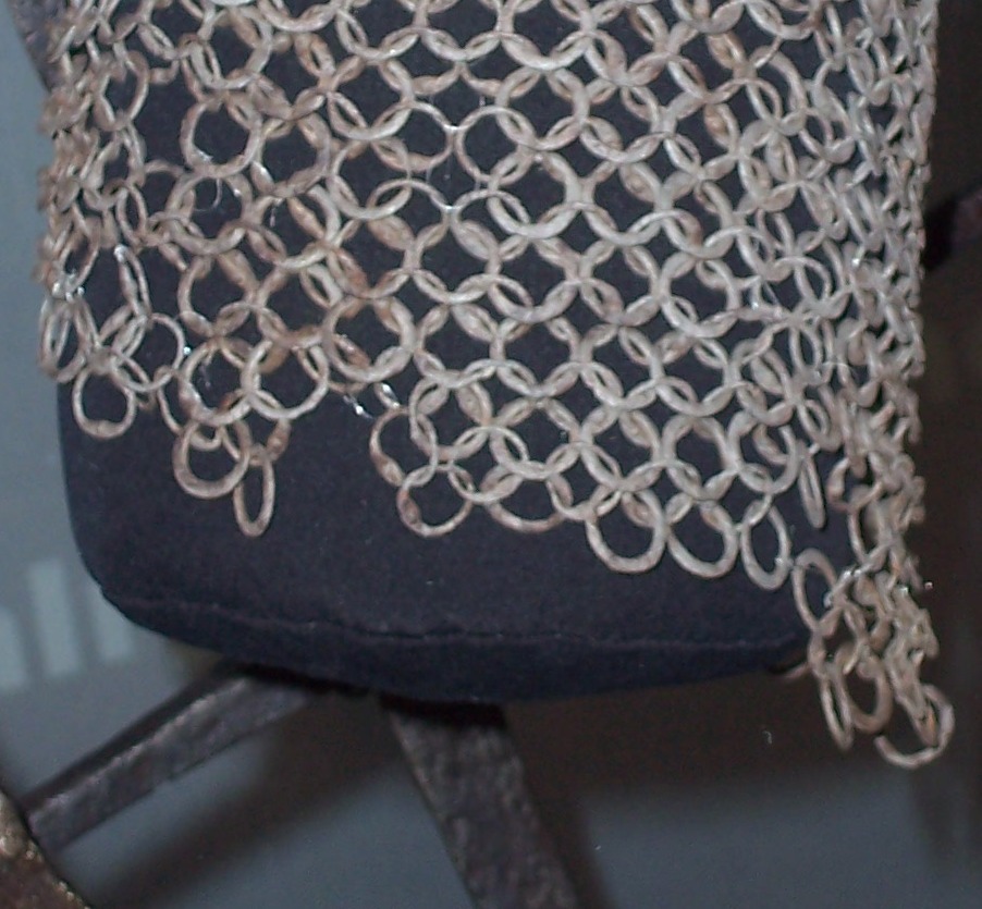

Yeah, but the modern dome rivets are nothing like the round rivets used in period. The heads are entirely too large and protrude too far on both sides. They are nothing like the round rivets...
Erik's maille looks totally different from the indian made maille. Thankfully I saved his pics of his maille before his website was hacked and heres how historical medieval dome riveted maille looked
Notice the backside is basically flat, modern dome riveted maille doesnt have that effect which is why it's so harsh on both the skin and gambeson. If only they made maille like that.
| S. Sebok wrote: |
[ Linked Image ] [ Linked Image ] Notice the backside is basically flat, modern dome riveted maille doesnt have that effect which is why it's so harsh on both the skin and gambeson. If only they made maille like that. |
Exactly. Round rivets in period are still closer to wedge rivets than they are to the modern dome rivets

Actually what I meant by flat was the rivets didn't stick out in the back like how they do on modern indian made maille. Thats one thing I cant really stand about indian made maille, the rivets stick out rather than are peened. That also makes the maille rather inferior in quality. Wedge riveted maille even when made by indian companies doesn't seem to have the issues with the rivets sticking out on both ends as they only stick out on one end. Now that i've seen the maille in person from both the front and back I regret my previous purchases.
I would like to know where to find this maille that has the peened over inside as well because I want to exchange my hauberk for it. If not i'll just get regular wedge riveted cause having a smooth inside is at least more period than having the ends of the rivets stick out on the inside. It's better than getting cut up and losing my new 300 dollar custom gambeson to maille with shoddy peening.
Long story short i'd say indian wedge riveted maille is closer to actual wedge riveted maille than modern indian dome riveted maille is to actual dome riveted maille. Maybe I will save some money and buy a hauberk off of Erik D Schmid now that I've been spoiled by his maille. My coif isnt dome riveted it's wedge riveted round rings though some rings are however flat and I believe it's 7MM, hard to find a maille hauberk that will match that but my main reasoning is more of a practicality reason rather than aesthetics. I don't want maille thats going to cut me and be rough to the touch and cut me and my gambeson while I put it on.
