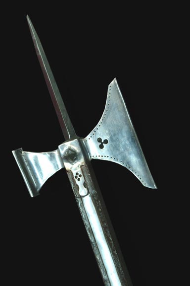

PostPosted: Mon 21 Jul, 2008 1:00 pm    Post subject:         Reply with quote
If you're willing and able to replace a Windlass haft, I'd encourage you to ask the Arms & Armour folks if they'll sell you an unmounted head. If they'll do it, it will at least save you the HUGE shipping expense of the mounted piece. They have this new poleaxe they're selling, mounted and shipped, for around $450. Almost $50 of that is shipping. If you could cut the shipping down by eliminating the haft, and get at least some kind of discount for the unmounted head, you might be able get one of the nicest poleaxes made for less than $400 and mount it to your own specs. I don't know if A&A is willing to do that sort of thing, but it's certainly worth asking if you're serious about polearms. Just think about what you'd spend for the equivalent quality sword.

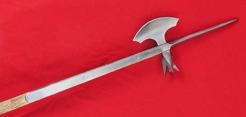

PostPosted: Mon 21 Jul, 2008 1:07 pm    Post subject:         Reply with quote
You also might want to consider the new poleaxe from Get Dressed For Battle:
http://www.gdfb.co.uk/acatalog/GDFB_Weapons.html
It's sold head-only for under $100. I think I've seen those for sale in the U.S. but I don't recall where. If I wanted a classic poleaxe on a tight budget, this is the route I'd go. Otherwise I'd save for a head-only purchase from A&A.
 Attachment: 31.66 KB

I've wondered about that piece. It doesn't look too bad, and the price is certainly right.
But the hammer face is what turns me off. It looks completely flat. Has anyone seen one in real life to confirm that this is the case?

Hal Siegel's Therion Arms Web-site has a profile view of the GDFB pollaxe head. The photo--the upper one of the two on that page--makes clear that the hammer-face is cut with grooves, probably waffle grooves, but is not toothed as many historical examples are. The URL is:
http://therionarms.com/reenact/therionarms_c1016.html
For comparison, the Arms & Armor pollaxe does have a toothed hammer-face:
http://www.arms-n-armor.com/pole010.html
I hope that this proves helpful.
