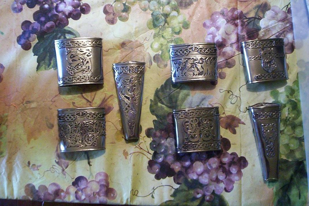

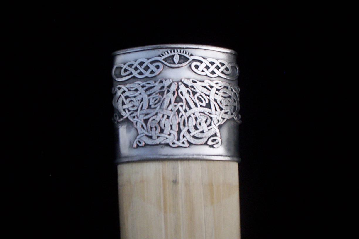

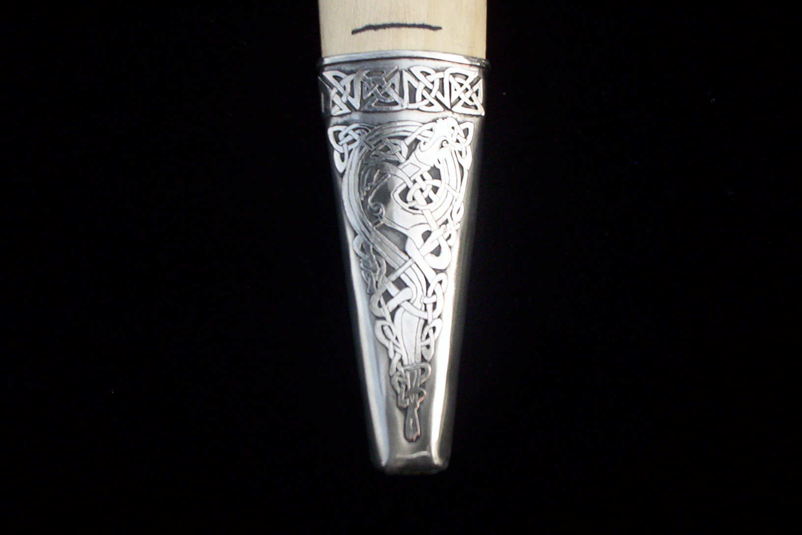

Also, we are working on an affordable line of custom scabbard fittings and details. Contact Russ at Tritonworks if you would like to include some of our pieces into one of his scabbards.
Thanks for your interest.
Sam
 Attachment: 149.59 KB
Viking/Celtic Scabbard parts [ Download ]
 Attachment: 143.71 KB
Custom Chape [ Download ]
 Attachment: 62.01 KB
Custom Locket [ Download ]
Custome Chape
