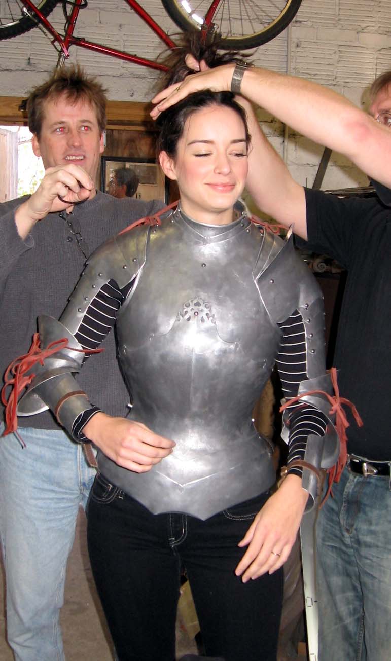

Gonsalo Jimenez de Quesada
PostPosted: Mon 16 Jun, 2008 8:02 am    Post subject:         Reply with quote
Patrick Thaden and Ugo Serrano made this armour for a fantasy film a couple of years ago. I don't know if PT is still working, but he and Ugo obviously have some recent experience in making custom armour for a woman.
