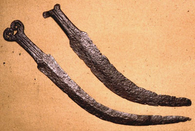

Akinakes c. 300 B.C.

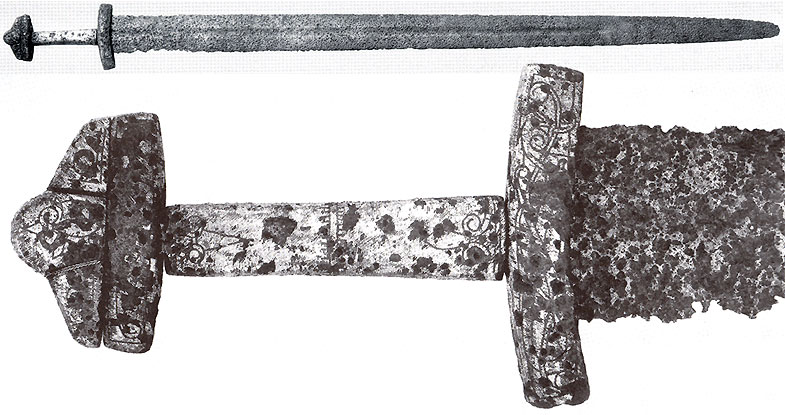

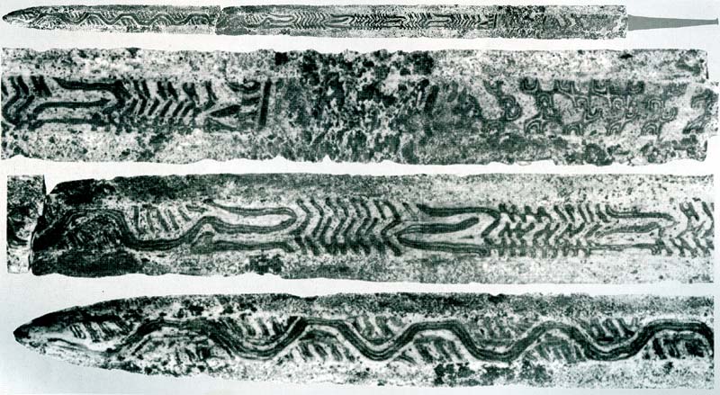

Find Place: Pappilanmaki Finland Photo from "Das Schwert im Fruhen Mittelalter" by Wilfried menghin

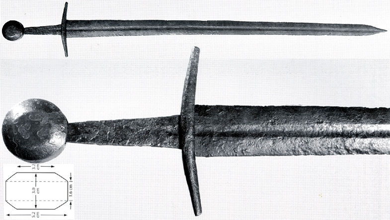

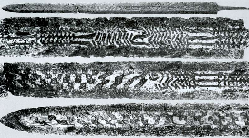

Find place: Vehmaa Lahdinko Huolila Finland 8th century. From National Museum of Finland Photo from "Swords of the Viking Age" by Ian Peirce
 Attachment: 98.8 KB

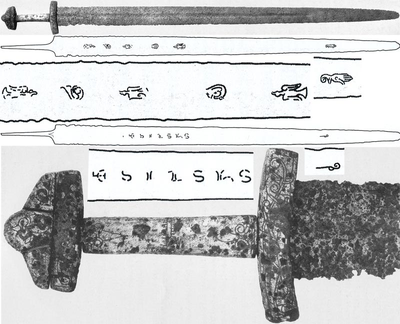

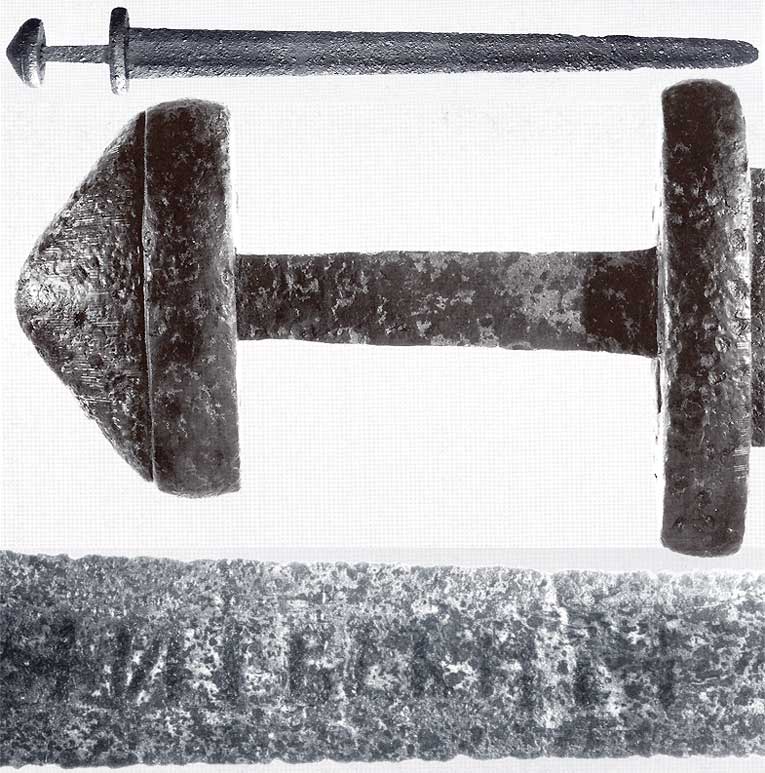

Find Place: Peltorinne Finland 9th century from Suomen kansallismuse, Helsinki Finland . Photo from "Swords of the Viking Age" by Ian Peirce
 Attachment: 90.14 KB
Find Place: Leikkimaki Finland 11th century from Suomen kansallismuse, Helsinki Finland . Photo from "Swords of the Viking Age" by Ian Peirce
 Attachment: 72.23 KB
Find Place: Vesilahti Finland 11th century from Suomen kansallismuse, Helsinki Finland . Photo from "Swords of the Viking Age" by Ian Peirce
 Attachment: 98.68 KB
Find Place: Kangasala Finland 10th century from Suomen kansallismuse, Helsinki Finland . Photo from "Swords of the Viking Age" by Ian Peirce [ Download ]

Find Place: Vammala Finland 11th century from Suomen kansallismuse, Helsinki Finland . Photo from "Swords of the Viking Age" by Ian Peirce
 Attachment: 91.58 KB
Find Place: Jamsa Finland 11th century from Suomen kansallismuse, Helsinki Finland . Photo from "Swords of the Viking Age" by Ian Peirce
 Attachment: 71.42 KB
Find Place: Marikkovaara Finland 12th century from Suomen kansallismuse, Helsinki Finland . Photo from "Swords of the Viking Age" by Ian Peirce

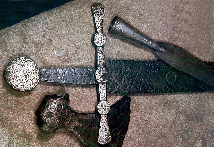

Find Place: Satakunta Eura Pappilanmäki Finland. from Suomen kansallismuse, Helsinki Finland
 Attachment: 98.6 KB
DISC.G.SilverWireInlay.SatakuntaEuraPappilanmäkiFinland.KansallismuseoHelsinkiFinland..jpg

Risto Rautiainen wrote:
...Some of those are new to me and especially the pics of those pattern welded blades are just awesome. They look like someone tried to show the whole arsenal of skill to produce different kinds of patterns. Cool!
Hey Risto...
Actually it is "blade" not "blades." Those are pictures of the different sides of the same blade! Eek!
I agree with you... The genius of craftsmanship in this blade is probably the best extant example of variety of forms in a pattern welded sword find. If my interpretation is right, it not only shows genius by also real determination on the part of the smith.
As best I understand it's construction from the images, it appears that the core on each side of the blade is made up of five billets (or bars). Thats 10 billets total. And that's not counting the other 2 used for the edges. In the upper section (strong part) of the blade, there are three billets alternating twisted and untwisted (straight) in line across the blade. In the lower part or (weak section) of the blade the core is made of two billets on each side twisted on their whole length with no straight or untwisted sections.
In the side shown in the lower picture, the radically different twisted pattern in the upper 3 billet and lower 2 billet sections suggests to me that these were built separately and then welded together in the middle. You will also notice in the lower section, as the pattern nears the tip, the twists go from diagonals to circles then back to diagonals angled in the other direction. My guess is that this is a feature of grinding the fuller. The deeper you grind into the twisted billet the more circles you see as you grind through the center to the other side it becomes more linear but in the opposite direction.
In the side shown in the upper picture, rather than building a 3 billet top and 2 billet bottom welding them together in the middle, it looks as though this Finnish genius built this whole side of the core out of three long billets. In the upper middle section you will notice there are alternating twisted and untwisted sections in line (as on the other side). However, in the middle (this it the genius part) the center billet is pulled up and the two side billets (which are now completely twisted) are welded together and then the middle billet, that was pulled up, is hammer welded as an inlay, back and forth like a snake, across the two-billet lower core! During this process something happened to the very top (strong) part of this side of the core and it was cut out and another three billet section was welded to it as a patch and then ground deeply. Then these two five billet sides of the core were welded together and then the edges were welded on.
So... .you can see, this is a fantastic example of what a determined Finn can do with a little iron and fire Big Grin

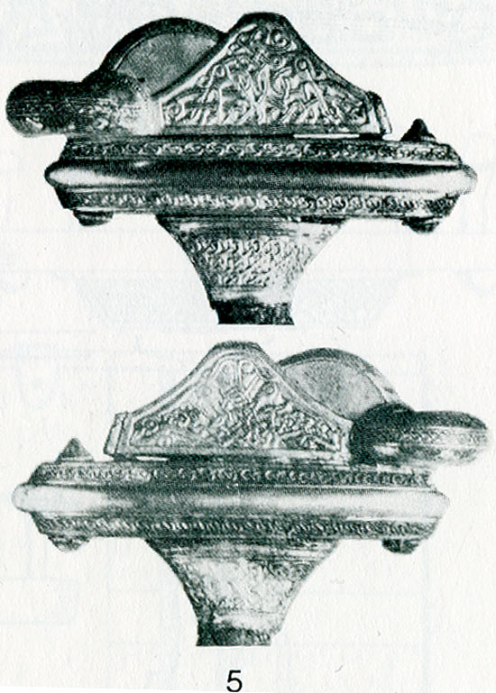

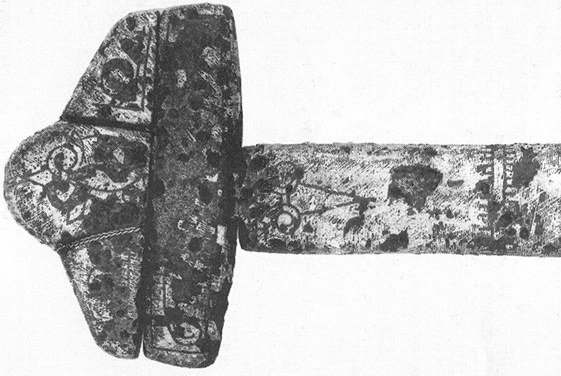

one of the other swords has an engraved handle. does anyone know the material?
Hey Audun...
If it is the Leikkimaki Finnland sword you are referring, then Pierce relates that it is silver plated with gold wire inlay. I assume that the base is iron. You can see in the attachment that the iron base was scored and then silver was burnished into the grooves. As the silver wears away in places you can see the grooving underneath.
The Christian inscriptions in the blade would put it in the 11th century. Pierce believes it may be a cerimonial sword because of the decoration and the fact that its Cog is 28.4 cm beyond the guard. Lots more info in Ian Peirce's "Swords of the Viking Age." If anyone is interested in swords of this time, this work is a must.

 Attachment: 98.5 KB
Detail of image from "Swords of the Viking Age" by Ian Peirce
 Attachment: 99.28 KB
Preserved in Suomen kansallismuse, Helsinki Finland . Photo from "Swords of the Viking Age" by Ian Peirce
Could this sword be the same that the Windlass Damascus Viking Sword is based on?
The Windlass replica is of the same type (Petersen Z) and there are around 20 of this particular type of sword found from Finland. But the Windlass description says it's from 850-900 AD which doesn't match with this piece...
Could anyone who owns the Records Of The Medieval Sword (by Ewart Oakeshot) check page 83 for me and tell me if it's the same sword as M2886:11 Petersen type Z pictured here on this thread?

On page 83 there is a drawing labled iv that seems a good match for the blade that you are talking about.
