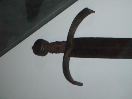

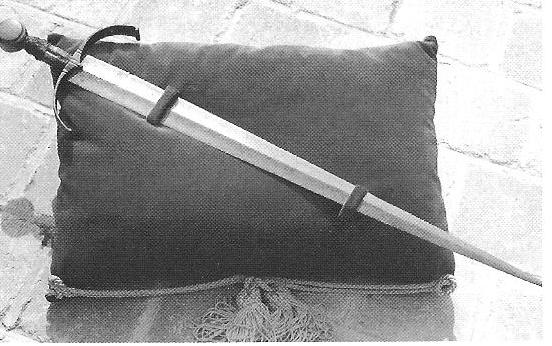

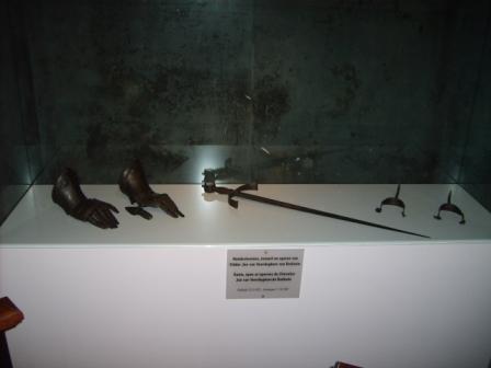

Hail,
Jan van Dadizele was a 15th century Flemish nobleman who led the Flemish town militia to victory against the french army at the battle of Guinegate at the 7th of august 1479.
His tomb is in the church at Dadizele together with his sword.
What type of sword is this and do you think it is authentic?
thanks,
Jeroen Averhals

Jeroen,
To me van Dadizele's sword is authentic. I think this is a broadsword, judging by its blade.

Posted: Tue 20 May, 2008 9:37 am Post subject: |
Looks real enough to me ,could always do with seeing it first hand.
First impressions make me think it is an xviii possibly an xv,although the heavily curved guard is far more common on an xviii

Jim McDougall
Posted: Tue 20 May, 2008 3:36 pm Post subject: |
I am inclined to agree that it is likely authentic, but difficult to say by photos. From what I can see the weapon seems to reflect patination with good age, and stylistically it seems right for the period. The sharp taper on diamond section blade with strong central ridge seems to correspond to a similar sword in the Wallace Collection (A495) which is stated Italian c.1490. The one in the Wallace has similar forward curved quillons, but cannot tell if the wide cross section exists on it.
In the Wallace example, Mann notes that it appears the hilt, of somewhat similar form is modern restoration, and more ornate. The very simple discoid pommel, and workmanlike guard on this suggest it is original. There was considerable trade between Italy and Flanders in these times, and arms and armour from Italy would not have been unusual,.Tthough the Wallace example slightly antedates the Dadizele example, the form would likely have existed earlier, and with this I would presume authenticity.
Thank you for posting this Jeroen! Its really nice that you and others post these great examples in museums that I know I will likely never see, and really appreciate the opportunity to see these great pieces.

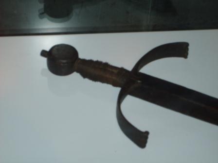

Posted: Wed 21 May, 2008 2:04 am Post subject: |
Thanks for all your replies,
I have found another picture in the book Dadizele by Jozef Dessein.
Jeroen Averhals
Attachment: 47.48 KB
![zwaard5 001.jpg](files/zwaard5_001_172.jpg)

Jim McDougall
Posted: Wed 21 May, 2008 7:36 am Post subject: |
Thanks Jeroen for the additional photo.
I think Fabrice is correct in being cautious in assessment as these swords in museums presented for display associated with important personages or events are often restored or remounted in varying degree. For example the swords attributed to El Cid in the Royal Armoury in Madrid and others.
While presuming dark age coloring or patina looks correct in photos, there is no comparison to actual handling of the weapon for authentication.
Mike Arledge
Posted: Wed 21 May, 2008 7:46 am Post subject: |
Well, regardless of when the entire package as it looks now was completed, it sure is pretty. This is a very good thread so far, thanks for posting it!

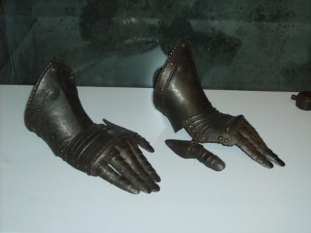

Posted: Wed 21 May, 2008 8:12 am Post subject: |
The gauntlets have a look, to me at least, that is more 16th century than 15th. Does anyone else share that opinion?

Posted: Wed 21 May, 2008 8:19 am Post subject: |
Chad Arnow wrote: | The gauntlets have a look, to me at least, that is more 16th century than 15th. Does anyone else share that opinion? |
Almost definately.
The sword's guard looks odd to me. That isn't to say it isn't authentic, I just have never seen one quite like it before, being very wide if you looked at it from above.
HistoricalHandcrafts.com
Jim McDougall
Posted: Wed 21 May, 2008 2:59 pm Post subject: |
Bill Grandy wrote: | Chad Arnow wrote: | The gauntlets have a look, to me at least, that is more 16th century than 15th. Does anyone else share that opinion? |
Almost definately.
The sword's guard looks odd to me. That isn't to say it isn't authentic, I just have never seen one quite like it before, being very wide if you looked at it from above. |
I agree, the thing that continues to concern me in looking at this piece is the flatwork cross section in the crossguard.
Jim McDougall
Posted: Wed 21 May, 2008 4:06 pm Post subject: |
I finally dragged out the monster! ("Armi Bianchi Italiene", Boccia & Coelho....its a huge volume!) and looked through it. The diamond section blade decidedly Italian and of 15th century, but the hilt seems to correspond more to Italian hilts of c.1500-20 (in profile at least). I am not familiar what hilt forms would have been indiginous to that period in Flanders, but again, the wide flat shape seems unusual.
I wonder if this might be a Flemish interpretation of the Italian style hilts ?

Jeroen Averhals
Posted: Fri 23 May, 2008 4:17 am Post subject: |
Hail,
Thanks for all your comments. I have attached another picture of the gauntlets.
Jeroen Averhals
