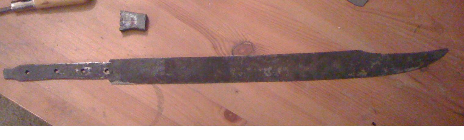

It's just over 27 inches in all...pretty short. Not sure if it still could be called a messer? I'm using the messers illustrated in Lechuckner:
http://mdz10.bib-bvb.de/~db/bsb00002184/image...p;seite=11
As inspiration.
Proportionally, it is similarly sized to a period illustration (can't find it at the moment)...basically, if suspended in a sheath as in the illustration, it hangs down to just about the same point on my leg as the illustrated weapon does.
It's hand-forged from 9260, it will have bone slabs riveted with brass rivets. Obviously, it still needs quite a bit of finishing work...it still has the forge scale on.
I'm just doing this for fun...I'm just a hobbyist. It's my first sword (if you can call it that)!
Dustin

This looks like a small archers falchion or a Italian falchion.
The blade is definitely a falchion blade.

I'm of a different opinion than Gary, and that's not to say that he's wrong and I'm right, I just have a different opinion. To me there is little difference between a falchion and a messer. By what I understand a falchion has a sword hilt with a stick tang and a large pommel on the end. A Messer has a full tang with a sandwiched scales with a bolster layed over the tang in two pieces a rivited on. Both can have a straight clipped blade and both had pretty much same history as a common man's weapon that was sometimes used by the aristocracy because of it's combat qualities.

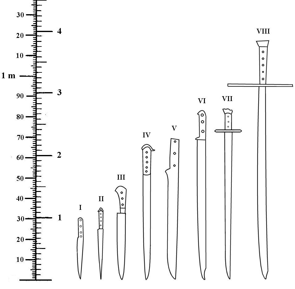

It's a weapon from the larger group of "riveted weapons" evolving in the 14th/15th century. The Bauernwehr and Messer belong to this group (the Falchion does not). This type of short sword with a crossguard is quite rare and mostly known from illustrations. Look at older postings from me about the topic.

A messer and a falchion have NOTHING to do with each other. The falchion is a much earlier development. Look at the hilts and compare: the falchion has a sword-like symmetrical hilt with a full grip, a pommel and a cross, whereas the Messer has an asymmetrical hilt that is riveted on the tang. The messer most likely evolved out of bauernwehr-like weapons in the 14th or early 15th century, at least it is part of a much greater development. In the late middle ages, riveted knives began to become more and more popular, and it is no coincidence that the first Bauernwehren emerge shortly after (one of the oldest pieces I know of is from ~1400 and was found in Heidelberg).
Remember that there are dozens of different types of weapons in the 15th and 16th century that all share the same characteristics: asymmetrical, riveted handles and a single edged blade. This is a development on its own that has nothing to do with the Falchion/Malchus.
Look at this schema I have made for my upcoming homepage. It shows different types of weapons. You can see the characteristics. The last two are Messers (Nr. V and VII are part of my collection).
Peter
