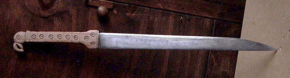

I was able to finish this sax along with my associate Michèl Cattaneo.
The blade is of classic broke back design, while the handle is derived from one in a german museum.
I think the handle reproduction goes very close to the original (pic provided by J. Zuiderwik)
Blade has a slight distal taper , it was made in a medieval forge with a modern power hammer (medieval walls help steel develop a better grain).
Blade length 44cms, thickness at base 6.9 mms tapering to5.3 at the beginning of the spine bend.
High definition pics here
http://bghomofaber.googlepages.com/saxfordukewarin2

For Russ Ellis
really happy for the compliments of a pro, thank you!
I followed an historical model so I went for the solar discs, even if hey were hard to make in the italian rovere (national oak) wood. Next time we will experiment with a different wood. We had made a steel tool to make them, as found in a publication about the langbardian solar disks that were impressed in lagbardian combs (substantially, viking stuff ..).
I wonder if I could make the next ones by burning them in with a heated iron tool
For Kelly
I used a straight tang, as in original, it is quite thick too (above 6 mms).
The handle is glued, as in originals: I used a modern glue for this task. Michel excavated the wood as a first step, then he copied the original design.
It is a bit rough if observed from a little distance.
As for the blade, Michel envisioned this finishing since we found, again in that appear about langbardian seaxes, that many specimen found here show signs of grinding on the blade body.
Grinding made with local polishing stones.
I have one of such stones, but we didn't dare finish the blade off with it as people would still not understand it, being quite crude, and we are not sure about the way they were finished, apart from the evident grinding marks that have appeared after chemical removal of rust.
Such seaxes still show some evidence of glued handles, but no hint of the shape.
In any case our reconstruction is for a brokeback type, while langbardians used a sort of bowie shape style, quite close to the frankish one.
Our inspiration attached down here
 Attachment: 61.31 KB

G Ezell wrote:
I really like the finish on the blade, it does not in any way look machine applied... Cool
Thank you, it is made by hand , as the blade & fuller.

Hi Bruno,
Nice! and attention to detail in going for an original finish, you could make patterns with that kind of finish with a little thought, I am thinking engine turning ( why is it called engine turning when it is done by hand?), but I have seen something like birds wings, feathers done with careful grinding, that kind of grinding is an art in itself and it would not surprise me if it was done then?
Hand finishing, great!
Lawrence

Solar discs = dot and circle?
Very common in period for a variety of materials. Good to see someone using that motif.
Bruno Giordan
Joined: 28 Sep 2005
Posts: 919
PostPosted: Thu 22 May, 2008 10:36 pm    Post subject:         Reply with quote
they are very common on langbardian combs, combs are abundant finding. Seaxees are too but the bone or wood handles are invariably decayed
This plaques are preserved in Santa Giulia Museum in Brescia (Santa Giulia is a langbardian founded monastery)
http://bghomofaber.googlepages.com/soalr-discs-web.JPG
Typical langbardian seaxes would look like this
http://bghomofaber.googlepages.com/seaxes-web.JPG[/b]
