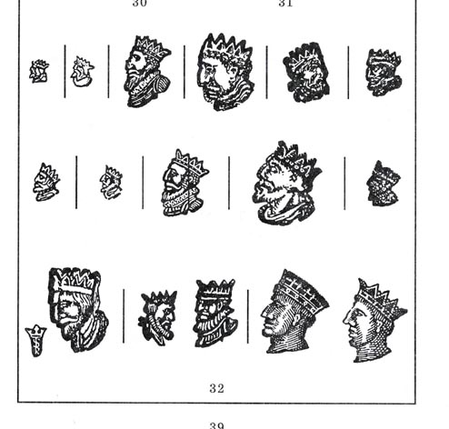

One difficulty is that the graphics in the books are drawings and can't truly render what the images actually look like on a blade. I'm actually beginning to wonder if some, or all the Wundes variations aren't actually etched and not a stamp. Some are certainly clear enough to have been engraved or stamped but a great may more are really very deep and ragged.
Another had offered up another page from a Russian title n German swords and swordmakers (no, i don't have the title).

Hi Carl,
FWIW, I think your sword's mark does look very much like one of the marks in the bottom row of the last page of marks posted. I don't have the title name of the book but it was indicated as a recent Russian edition. This is the slender mark facing audience right, above the 32. I am pretty much completely in the dark on this myself but to me the marks look like they were quite varied and all apparently attributed to the Wundes forge(s). I have also wondered if it was not being used somewhat generically, like the Passau running wolf but I have not found text to support that and am relying on those with the texts describing the whole line of family that was Wundes. If these were beiing etched, instead of stamped, it would also help explain the great variety we are seeining as technique and resists might have changed s frequently as the hands applying them. The "how" of the way they were being done is as much a quandry to me as finding good photos fof extant pieces with marks to view instead of drawings from books.
