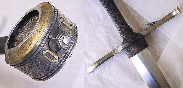

I've seen the wonderful pommel photos of the famous Bayerisches Nationalmuseum XVIIb (see below,) but I've never seen any equivalent images of the cross. The pommel appears to be selectively gilt. Does anybody know if that's true of the cross as well? If so, what parts of the cross are gilt? I'm toying with the idea of a blued and gilt hilt for an A&A Dürer, and would love to know more about historic decoration of this sword type.

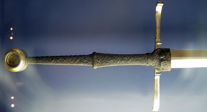

PostPosted: Tue 29 Apr, 2008 8:23 pm    Post subject:         Reply with quote
Here's a shot of the whole hilt, taken by our own Craig Peters I believe.
Dan
 Attachment: 40.09 KB
PostPosted: Wed 30 Apr, 2008 6:36 am    Post subject:         Reply with quote
That's what I needed. Thanks, folks! Not sure why I didn't turn those up in the search that netted the pommel photos...
When this steel was new and polished, this decoration must have been very subtle.
PostPosted: Wed 30 Apr, 2008 7:09 am    Post subject:         Reply with quote
Are my eyes going batty? On the pic I posted, it looks like the center facet of the guard is gilded. On the pic Dan posted, the center facet looks like steel, while the outer facets are gilded.
PostPosted: Wed 30 Apr, 2008 7:35 am    Post subject:         Reply with quote
I think you're right, Chad. Looking closer, I think we may be seeing both sides of the cross. Note the old accession number on the left quillon in the photo you posted.
Very interesting....
