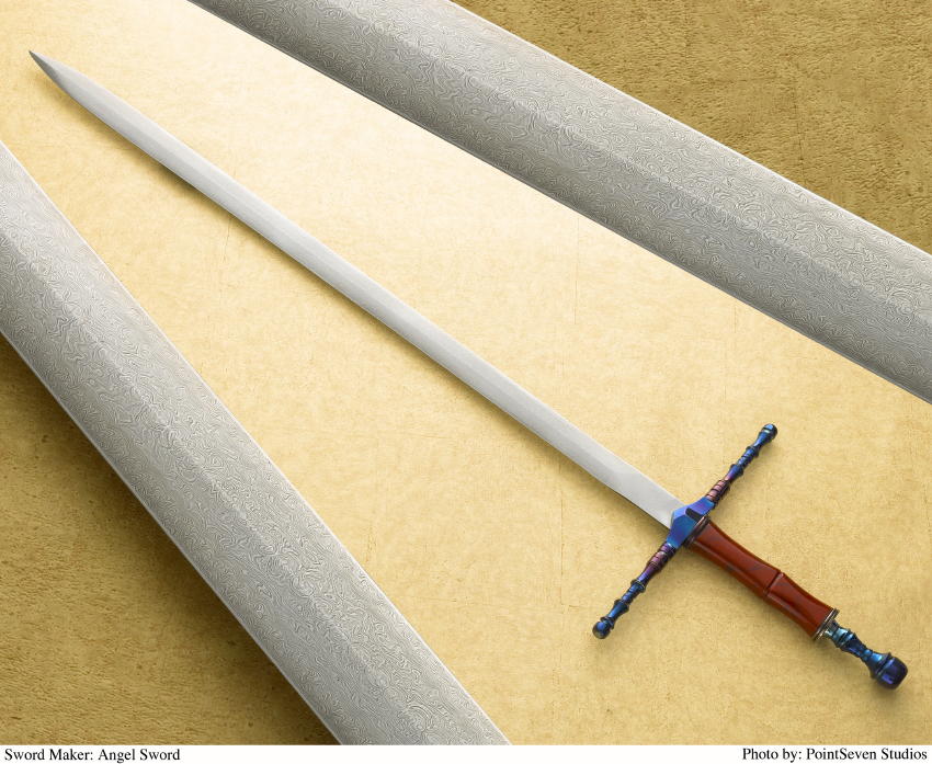

I currently own 5 antique wootz blades, and have owned/sold 10 to 15 more. Now I enjoy making my own versions of wootz. Here is one I forged:
