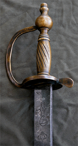

A full review is underway, [FULL REVIEW NOW POSTED BELOW] but I wanted to go ahead and share the results of the antiquing. An original-- with cleaned hilt :-( --is pictured below the replica. I may decide to clean the replica hilt a bit more. Still deciding. Anyway, I'm very pleased with this purchase. $100, incl. shipping, from MRL.

It's a very simple process. Just vinegar & salt in a spray bottle for the blade (do this FIRST) followed by steel wool 24 hours later. The finer the mist you can get from the bottle, the better. Ammonia fuming for the brass, again followed with fine steel wool 24 hours later. I was too eager to fume the hilt and learned the hard way that vinegar makes an exceptional brass cleaner. Had to scrub off some of the patina and start over. I also learned that fuming the hilt, then scrubbing it a bit with fine steel wool, fuming it again, scrubbing it again, etc. gives the impression of an antique that's been cleaned a few times. The patina builds up strongly in the recessed areas, as you can see, and rubbing off the raised areas suggests years of handling. All the fumed brass needs a bit of light wool-work to remove the blue-gray haze that overlies the buttery patina.
I was AMAZED that this blade was not lacquered, but only oiled. Woo-hoo! I was DISMAYED that the hilt WAS lacquered. Boo-hoo! Fortunately, it was a light coat that came off easily with a half-hour treatment with Citrustrip followed by fine steel wool. If you leave any lacquer, you'll get bright spots in the patina. I would recommend stripping the lacquer even for those who want a pristine finish. Lacquered brass is cheap looking. The cleaned and polished brass is dazzling, almost silver. By the way, the patina produced by the ammonia fuming is very deep and durable.

Here's a detail that also shows the quality of the etching.
This is a relatively light treatement of the blade. I really wanted only staining on this piece, but a 17th c. backsword I antiqued is a dark,rich grey-brown and appears to have multiple transparent layers. This hanger would develop same with multiple sprayings & cleanings, with longer rusting times.

By the way, Kirk, if you do try ammonia fuming, be aware of different effects depending on how the fuming chamber (aka "cat litter bucket") is ventilated. If relativley well sealed with a garbage bag, as in this case, the vapors may condense on the brass and create spots of darker patina. These can be left or polished out with the steel wool. I ilked them, and simply blended them in a bit. If the chamber is not quite as well sealed, the patina may be more even and predictable, with no darker areas from condensation. Experiment. It's easy enough to clean the hilt and start over if you don't like the results. In any case, the multiple treatments do create an overall richer effect.
PostPosted: Mon 22 Mar, 2004 10:04 am    Post subject:         Reply with quote
Here's a detail of the pommel area. I created the pits and scratches you see here (darker because the steel wool doesn't get unto them during cleaning). The casting of the brass was flawless before I rolled the hilt around on a cement driveway to give it some scars.
 Attachment: 115.63 KB

I think it handles very well. You can feel that it's a powerful cutting blade, but the point of balance is near the hilt-105mm (4") below the hilt, to be exact. The comfortable balance owes much to the fullering of the blade as well as to visible distal taper. The blade back is 7mm (.25") thick at the ricasso, but tapers down to 3mm just before tapering even more strongly toward the false edge, which runs for 100mm (4"). I really love the way this weapon feels in the hand. Feel is subjective, of course, but the fullers and distal taper aren't just for show. Keep in mind that this replicates a general-issue military weapon that even in its heyday was considered the third line of the infantryman's defense/offense. I wouldn't be at all surprised if these were used more often to attack underbrush than to attack the enemy. That's why 18th century American infantry abandoned swords for belt axes and knives. If I'm correctly interpreting the Viginia Muster of 1624/25 (open to debate), even at that early date the colonists may have recognized the limited utility of the sword...but that's another story.

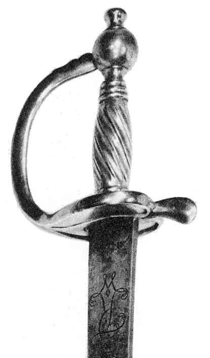

I am resurrecting this very old thread, since I am able clarify a question raised:
Sean Flynt wrote:
* Unlike most published examples of this weapon type, only the outboard side of the replica’s grip is fluted. I can't tell from published examples whether this is true to the type on which this particular replica is based, but it would seem strange for Windlass to overlook the accuracy of the cast grip when they've given so much attention to less obvious details of their replica. ....
I was perusing the web site of an antiques dealer (thanks to Jonathan Hopkins for the link!) , and I found a listing for a German Infantry Hanger. Lo and behold, I found pictures that validate the grip design of the MRL hanger, with fluting applied only to the outboard side of the grip, and the inboard side left smooth. Here is one of the photos, showing both the inboard side and a little bit of the outboard side of the grip.

My pleasure, and wow, what a memory! This thread is 2 1/2 years old! That is an interesting detail that I never knew about before--thanks for bringing it to light! I guess money and material was saved by embellishing only what would be visible?
