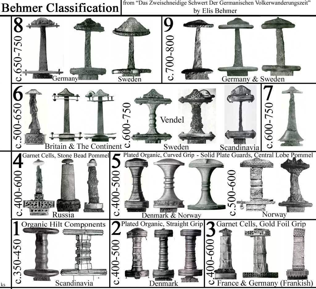

While I'd really like to think that the horn hilted sword you posted is the prototypical Germanic sword, I do have trouble believing that it was so widespread over the entire Limes.
This type is what Behmer calls his Type I, and according to his inventory, this type contains only three intact hilts:
One from Nydam, Denmark, one from Evebř, Norway and one from Cumberland, England. More fragmented finds are from Sweden and Denmark. Behmer thinks it's an indigenous Germanic sword, perhaps inspired by Roman examples.
The metal hilted Behmer Types II and V are also mainly Scandinavian. See here for a distribution list:
http://www.myArmoury.com/talk/viewtopic.php?p=204398#204398 and the attachment for an overview of the Behmer types, thanks to Kirk Spencer.
I'm not sure what the new publication on the swords from Illerup Adal says about it, as I have not read those books yet, unfortunately. Most of the swords I've seen so far from Illerup Adal have the perhaps more "typical" Roman spherical pommel, but perhaps decorated in a "Germanic" fashion. A few of the blades are definitely Roman.
Attachment: 150.46 KB
