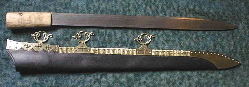

No not exactly. I have seen a lot of recreations of these knives and I only have one poor picture of a grave find from Birka. I have no idea where to get hold of a proper report for things like sizing etc.
The kind of thing is shown in the attachment as made by Holger Ratsdorf of HR Replikate.
I'd love to make one to as acurate a standard as possible.

That looks like a sax to me ;)
Saxes from Gotland, Uppland – Viking or Vendel period, click on the “i” icon for info on period, size etc., the first looks pretty similar to the repro you posted:

David, from the picture of the reproduction that you posted, I'd say that it is a form of a seax, of which there are many sizes and styles depending on time and place. There are several articles on seaxes here and on the knife making forums where they seem to be rather popular at the time. I have to admit that I've been bitten by the seax bug too and have some ideas of forging more of them when I get some other ideas and commitments out of the way.

That first link is a pretty cool sax from Viking era Birka, long and lean with a short handle that visually emphasizes the blade. There’s a lot of good info in these museum photos for a repro.
