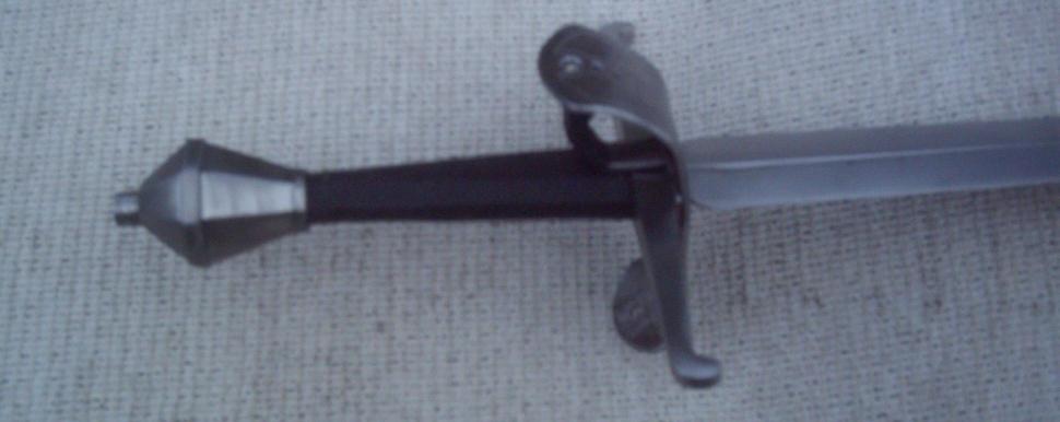

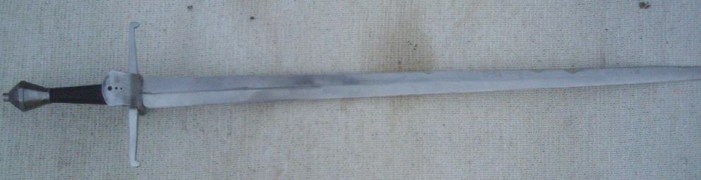

Hi everyone. I just fixed my wife's camera, so i can post some of my weapons now. :-)
Up first is this cut & thrust sword I hilted a while ago. I made it following a thought experiment where I tried to think of the most simple, yet most protective hilt for a cut and thrust blade, with the added goal of being very open and ambidextrous.
I didn't follow any examples whatsoever, but I know that very little is new in the world, and wondered if anyone had seen a hilt like this.
Note the way the thumb ring can also be used by the index finger, depending on whether one wants to be more cut or thrust oriented.
Sorry for the poor picture quality. "fixed" does not mean "good".
 Attachment: 34.42 KB
 Attachment: 41.44 KB
 Attachment: 42.34 KB

PostPosted: Thu 17 Jan, 2008 8:34 pm    Post subject:         Reply with quote
Not exactly like that, no, but it reminds me (loosely) of either a sinclair saber or the Italian example in the bottom-left of this feature article. Basically a combination of quillons and shell guard or knuckle guard, which I don't think is functionally unique but certainly not usually appearing as you've realized it here.
Anyway I look forward to seeing closer examples (or, undoubtedly, much better-informed opinions) of this basic guard form.

I wonder if the ring really helps in your thrust-oriented grip? In my understanding, fingering the ricasso on rapiers and cut&thrust swords provides a better feel essentially by shifting the hand further towards the center of gravity, which does not really happen with this grip. Does the ring really change the mechanics of the grip?
The position of your hand relative to the quillons and edges is sowewhat similar to what Girard Thibault advocates for the rapier, the biggest difference being that your wrist seems to remain on the top of the pommel, when Thibault puts more on the side. Thibault's position seems more relaxed, and lines up the forearm better with handle. I think this could take a better advantage of the hilt's coverage as well...
Also, how easy is it to switch between these two grips? This could be important for a polyvalent sword.
I have seen saber hilts with just quillons and thumb ring, so your design seems like something logical to do to increase hand protection. But the use of these two grips you describe prevent the addition of a knucklebow, which would be impractical with the thrusting grip. Perhaps people tended to stick with one hand position, in order to be able to get better hand protection?
Vincent
Ensis Sub Caelo
Jerry Knox
Location: Palm Bay, Florida, USA
Joined: 12 Jun 2007
Posts: 53
PostPosted: Mon 21 Jan, 2008 4:24 am    Post subject:         Reply with quote
I find that the ring actually increases control and sensitivity in the thrusting grip, much like the index-finger stud on a fishing rod does. The same could have been accomplished by cutting into the grip material, allowing the index finger to grip closer to the main axis of the blade and "hook" around the thicker portion of the grip, but would not have done double-duty as a thumb ring, which I really wanted. My favorite feature of this sword is that it can be used in "cutting mode" two-handed by gripping the pommel, which turns the largeish blade into a real meat cleaver.
My wrist could have been more in-line without discomfort, that's just how it ended up for the picture.
The ease of switching hand positions is pretty great. It is especially easy to go from cut to thrust, and not difficult to go back. The large ring allows me to just rotate the sword while touching my thumb-tip to my index-fingertip (think the "OK" sign) until it settles into either position.
Weekend Update: after using this sword in some light cutting and thrusting, I find that it definitely favors the cut due to the blade presence, but that in either grip, the ring feature allows more control than if it were not there. The index-finger grip DID definitely increase tip control the most though. Also noticed that with the thumb ring, it was slightly more difficult to use the back edge quickly after a forehand cut. Is this a common effect of thumbrings?
Thanks for the great replies everyone!
