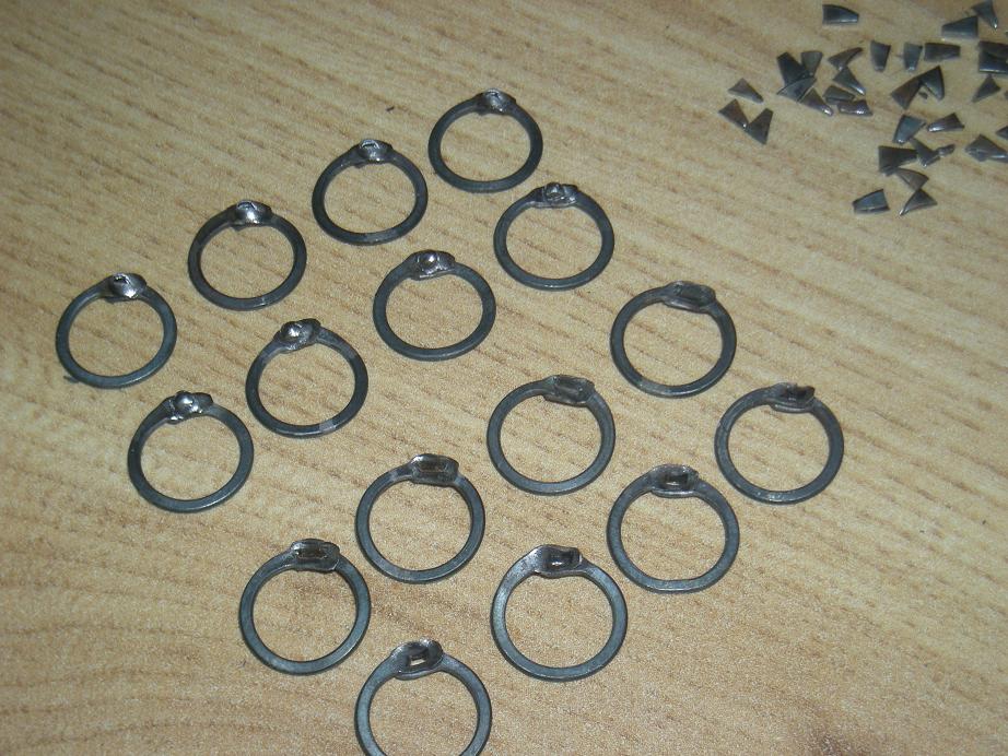

What do you think of this riveted maille.
 Attachment: 119.93 KB

If you are wondering did flat maille come with round rivet heads instead of wedges then the answer is yes; in fact it is more common in extant examples:
Museum of London; 14th century
Leeds Museum; 16th century:

Thanks for the pics. The thing is really, that this cheap maille, though riveted is far away from the original. The example of the 14th cent looks like flat punched ring mixed with round ring riveted. Is that correct?

I think it was flat punched ring mixed with round ring riveted now that you mention it. That too is common place.
