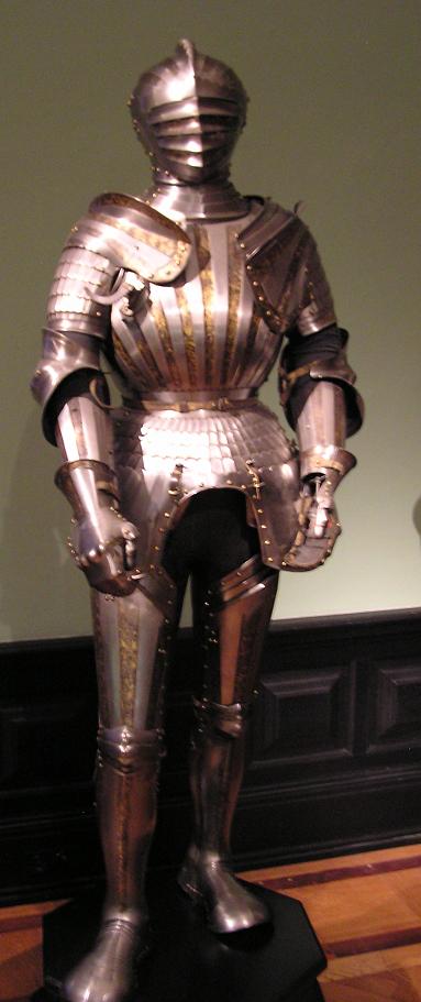

If you look at the proportions of Maximilian harnesses, you can tell that the "waistline" is usually located above the hips about towards the lower region of the stomach, a couple of inches below the floating ribcage. I'm providing three images of harnesses from the second and third decades of the 16th century that are good examples of the standard Maximilian look.

About breast lates... I was just looking some Maximilian armours and i noticed that there was something that didn´t fit.
First of all, i was told that the base of the breastplate, were the belt is placed, is at the same level of the navel ,but the navel is 2 heads of distance from the chin.
This armours had the belts around 1 1/2 or 1 3/4 heads distance, Whats wrong?
I supossed that they were child armours, but having seen those armours more carefully, i noticed that some of them were actually adult height.
What do you think?

I think the exactness of the navel idea may be a bit faulty. From one man to another a torso can differ in height, and I assume that in general the "belted" area of the cuirass was somewhere between the navel and the floating ribs. Think of this point as where a woman's corset is most likely to cinch the tightest. It may be right on the navel, but looking at the way some people are shaped from their hips to ribs, it could also be a tad above that.
I think the fluctuation would be based on the individual, most likely. If you are in fact looking at adult-height armour, then it is simply a matter of style or personal functionality (based on the original wearer's measurements) that could be causing these distortions.
Also note that if you're using the helms to measure your "heads" then you would be exaggerating the times you are measuring with. Each helm is certainly taller than a man's head, and if you compare the helm to the cuirass to measure heads against torsos, the image may be distorted. A cuirass is certainly the same height as the torso it's made to fit, but the helm is usually taller than a human head, to allow padding and a bit of open space as a buffer from absorbing blows with the skull!

About bothering the ribcage i´m refering mostly to the maximilian breastplate, but specially the one in the third picture you posted. I mean, Don´t you think that the breastplate waistline could be compressing the wearer´s body too much, and maybe it could be harmful for his bones?
