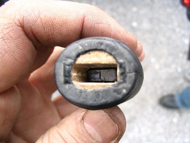

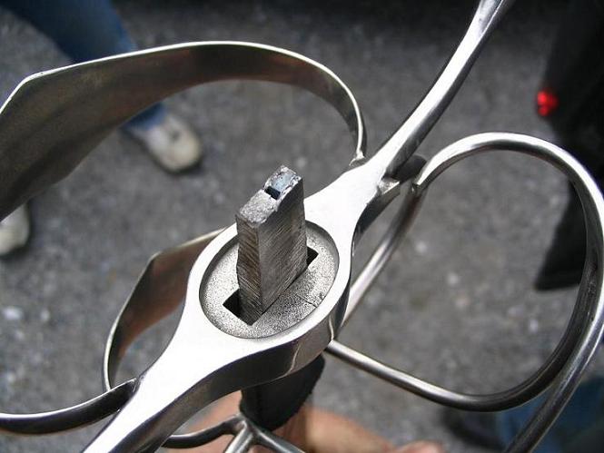

This came into me today from a customer who owns hundreds of weapons ..... he was asking if it was worth repairing.
I am personally astounded at this type of construction. This is exactly why I tell people I would never consider product like this for any kind of contact. In this case the blade is even sold as a blunt specificly for stage use!

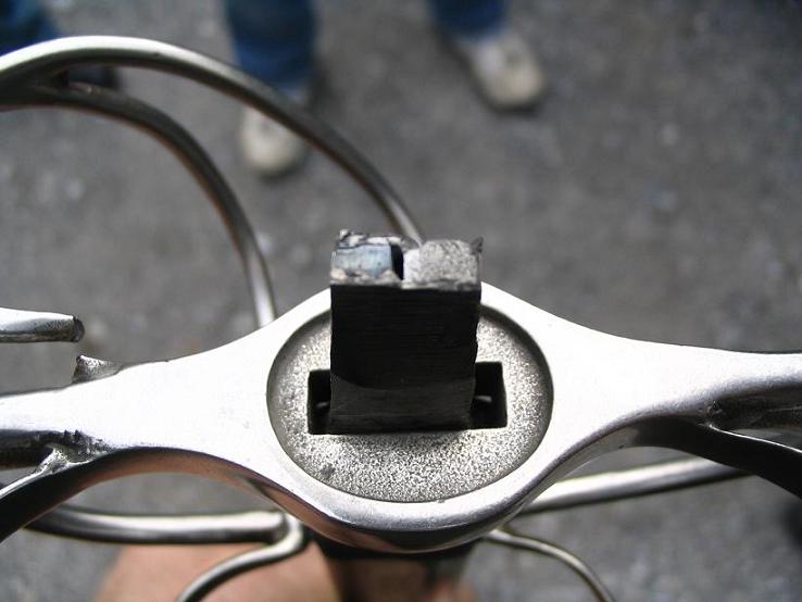

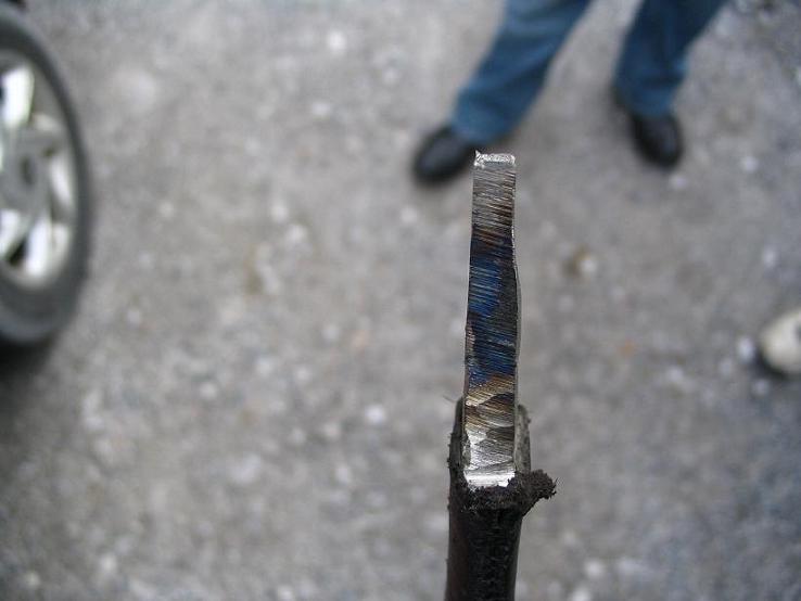

This tang was so small and lopsided that it appears they welded in a couple of tiny bars to make up the difference. The welds have no penetration and the tang makes this sword worthless other then to hang over a fireplace.
Maybe they figured if its under the handle it doesnt matter. Amazing

Lance, can you check the tang on yours and compare? If there are several of these out there among members it should be easy to tell if the construction is similar. The owner of this sword has 3 more and is going to check them as well.
If we can check several blades like this and determine if this was an oddball or not, it certainly helps everyone to know what to look for. The guard being fragile is much less of an issue as you can determine by EYE if it is suitable for the intended work, it is also easy to repair.
It was EXACTLY a discussion like this that got promises to fix the hollow pommel issue. If I remember correctly another maker was involved in that discussion as well...

If you look at pic # 2 there is discoloration where the weld is on the tang. This would be a pretty clear indication of a weld, different 'color' metal. It would show up more if the tang is heated from rough grinding like in the photo, but even under polish you can see welds at the dissimilar materials show. It is fairly hard to see if the metal is scuffed like a scotchbrite pad would do.
I would like to say that under certain circumstances welding on tangs and blades IS acceptable. It must be done with a similar material, fully penatrating the steels and heat treated afterwards. Welding is about making 2 or more parts one. It doenst have to be pretty , just strong!

I don't see any different coloring between metal, though.

To be honest, that extended tang weld looks pretty good from the pic. Welding on a piece of mild to use less laminated steel was the norm among many makers in the 80's and 90's, less so now that more info and simpler forge welding tecniques are out there (presses and such) . So long as the metals are fairly close in carbon and are properly welded I dont see any problem with that. The threaded part welded on is also pretty standard and if done right usually can hold up just fine. It appears from the pic that it broke on the thread itself and not the weld? I cant really tell. If so then most likely the material of the added thread is usually the problem, not the type of construction. Material for added threads are a huge debate as well. most like reheattreated hard bolts, I like very soft and flexible rod, that debate has been going on for years.
The broken blade is another thing entirely, but if the replacement has held up well and the importer replaced it for free then It looks like like they sorted it out.
I was informed after some debate these 4 swords will be returned so I guess this turns out ok.
