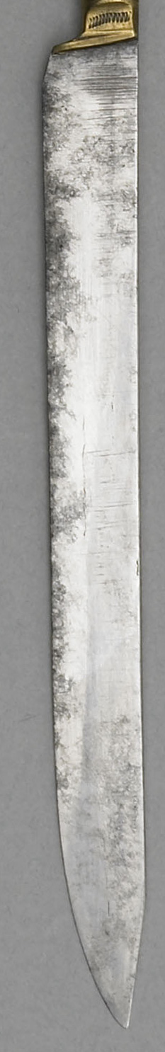

I like this sword very much!!! I really like the pommel! Are the black spots on the blade imperfections in the metal? They seem out of place in an otherwise very technically sound reproduction. None of your other reproductions seem to have them......
Black spots are signs remains after forging. When I forge the sword, I'm trying to make piece close to the shape of finished blade. If it is too close, black spots left after grinding. It was lesson for me, that I should begin forging from a bit thicker material. If you look at my other pictures (XVa, messer) you will find small pits on the blades.
Besides, historical swordsmith left small pits on blade too. It was fairly common, as far as I know.
