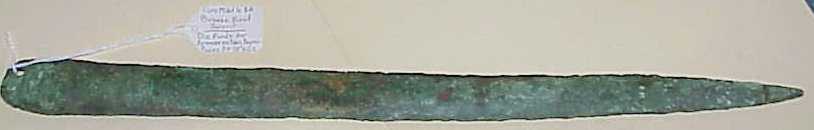

In October of last year I was the successful bidder on the Hermann Historica, Munchen, Bavaria, Auction 45 Lot 1129 which included bronze pieces that included two pins, an axe and the sword below.

Lot Nr.1129 Schwert und Beil, bronzezeitlich, um 1200 v.Chr. Bronze mit starker grüner Patina. Kräftige Klinge, am Ansatz zwei Nietlöcher, eines mit erhaltener Vernietung. Randleistenbeil mit gerundeter Schneide. Dazu zwei verbogene Bronzenadeln mit Kerbdekor und flachen Abschlussköpfen. Gereinigte Bodenfunde. Länge 16 bis 44 cm.Condition: II-III Limit: 500.00 EURO

The sword 1s 17.3" (44 cm.) long and retains one of the rivets. I figured my cost for this sword at $550. The rivet is .5" (1.4 cm) long and I have no idea how this could have been securely mounted to a hilt, hope someone can make a suggestion. The rivets extend less than .25" from the blade surface.
I date this sword to 1600 BC, Middle Bronze Age, but it could be earlier, the axe in the lot dates to the Late Early Bronze Age, several hundred years earlier.

I should point out that while the attachment point is very weak, the sword blade itself is quite robust and sturdy, the foundryman who cast it was not short of metal. The cross section is lens shaped and the blade still retains an edge but not a sharp point. I would like to get a metallurgical analysis at some point.

Interesting that the edge shows signs of having been sharpened while the point does not. The Bronze Age "rapiers" from Ireland showed a similar "weakness" in that there are no tangs; instead, like your purchase, the hilts are rivited directly onto the blade itself. This construction has led to the assumption that these weapons were primarily used for thrusting.
The fact that your sword seems to show that it was used for edge-work makes me wonder if the collective wisdom about such swords is in error. Is it possible that the smiths overcame the apparent weakness in a way that we haven't quite guessed?
